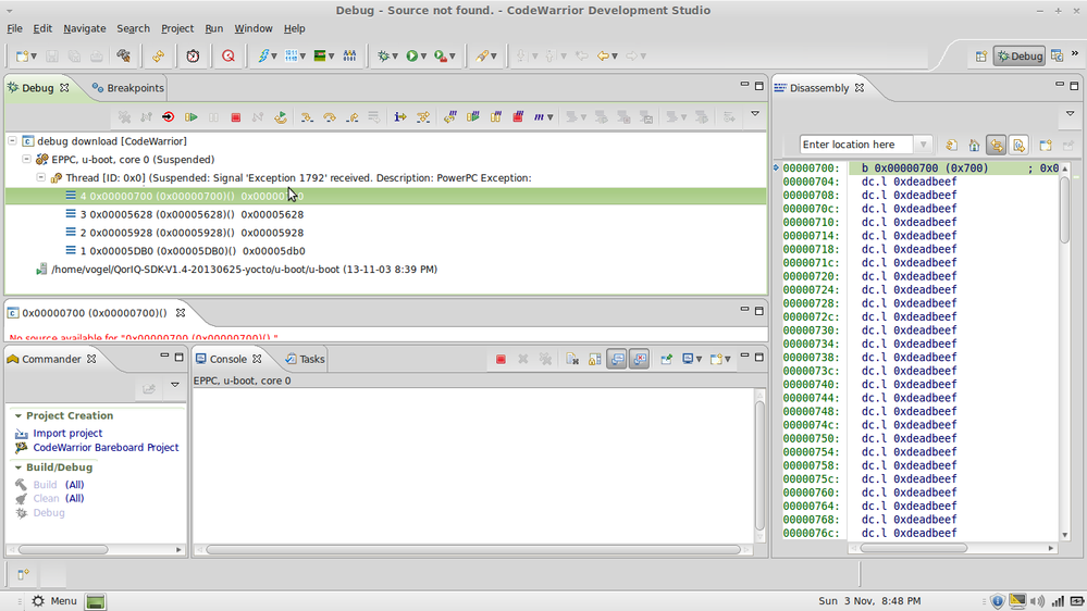

I have a Freescale P1020rdb-pc development kit, Codewarrior Tap  and am using CodeWarrior 10.3 in Linux for development. (LinuxMint OS).
U boot source and toolchain is the from the Freescale SDK1.4 Yocto package.
I am sucessfully able to build u boot with the GNU cross compiler and download uboot.bin into NOR flash using CodeWarrior and the Tap.
The P1020rdb-pc starts up and runs fine. Now at a point where we need to be able to debug u boot as we will be customizing the hardware.
I set up debug configuration to Download.
When debugging using Connect, seems to run fine, here is the console output:

Then CodeWarrior switches to Debug view, but there is an exception:
I have some moderate success with Debug configuration Attach. However am not able to step through code as I would like.
Any suggestions would be appreciated.

First of all, for debugging u-boot with CodeWarrior, you need to build u-boot with CodeWarrior support, please use the following steps in SDK 1.4.
1. $ cd <yocto_install_path>
2. $ bitbake -c cleansstate u-boot
3. Modify the u-boot_git.bb file and add following content:
$ cd meta-fsl-ppc/recipes-kernel/u-boot
$ add 'EXTRA_OEMAKE += "CONFIG_CW=1"' in u-boot_git.bb file
4. Rebuild u-boot:
$ bitbake u-boot
Then import the elf file in CodeWarrior from File->Import->Power Architecture ELF Executable.
Secondly, in u-boot debugging please use the initialization file CW PA v10.3\PA\PA_Support\Initialization_Files\QorIQ_P1\P1020RDB_uboot_32.tcl instead of P1020RDB_init_core.tcl, then use attach method to debug u-boot. P1020RDB_init_core.tcl is used to reset and initialize the target, then download elf file into the target.
For detailed steps of debugging u-boot from NOR Flash, please refer to the section "5.4.6.4.2 U-Boot Debug from NOR Flash" in page 259 of CW PA v10.3\PA\Help\PDF\Targeting_PA_Processors.pdf.

tomvogel
Thank you Yiping.
I should mention that I had extracted the uboot source from Yocto, and installed the fsl_toolchain. I had in fact created a stand-alone uboot project in that could be compiled in CodeWarrior.
Using your advice, I imported the EFL executable from that project to create a 'uboot debug' project. Also used the correct initialization file P1020RDB_uboot_32.tcl.
I am able to set a breakpoint, attach then reset and stop at breakpoint in source.
Stepping though source seems to work so  far.
Can you tell me what effect the flag 'EXTRA_OEMAKE += "CONFIG_CW=1"' has on the build, as I do not seem to have used it.
Tom

marius_grigoras
Historically, this macro was used for enabling the debugging support necessary by CodeWarrior. Right now, this macro is deprecated and is no longer used. The debugging support is enabled by default for the most of the boards.
Marius
