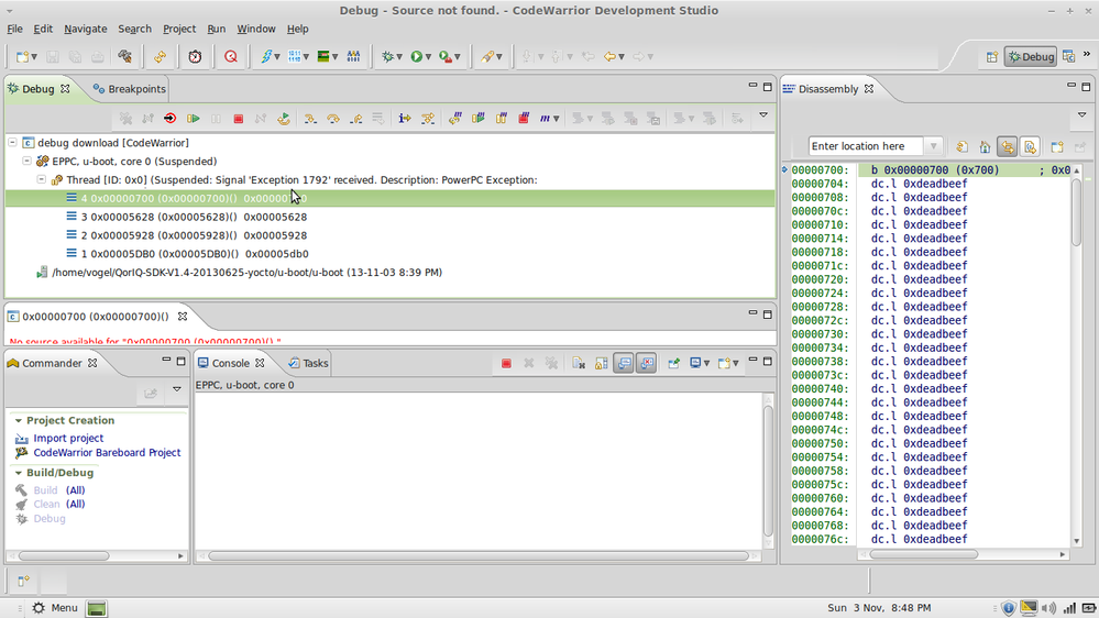

Then CodeWarrior switches to Debug view, but there is an exception:
I have some moderate success with Debug configuration Attach. However am not able to step through code as I would like.

First of all, for debugging u-boot with CodeWarrior, you need to build u-boot with CodeWarrior support, please use the following steps in SDK 1.4.
1. $ cd <yocto_install_path>
2. $ bitbake -c cleansstate u-boot
3. Modify the u-boot_git.bb file and add following content:
$ cd meta-fsl-ppc/recipes-kernel/u-boot
$ add 'EXTRA_OEMAKE += "CONFIG_CW=1"' in u-boot_git.bb file
4. Rebuild u-boot:
$ bitbake u-boot
Then import the elf file in CodeWarrior from File->Import->Power Architecture ELF Executable.
Secondly, in u-boot debugging please use the initialization file CW PA v10.3\PA\PA_Support\Initialization_Files\QorIQ_P1\P1020RDB_uboot_32.tcl instead of P1020RDB_init_core.tcl, then use attach method to debug u-boot. P1020RDB_init_core.tcl is used to reset and initialize the target, then download elf file into the target.
For detailed steps of debugging u-boot from NOR Flash, please refer to the section "5.4.6.4.2 U-Boot Debug from NOR Flash" in page 259 of CW PA v10.3\PA\Help\PDF\Targeting_PA_Processors.pdf.

tomvogel
Thank you Yiping.
I should mention that I had extracted the uboot source from Yocto, and installed the fsl_toolchain. I had in fact created a stand-alone uboot project in that could be compiled in CodeWarrior.
Using your advice, I imported the EFL executable from that project to create a 'uboot debug' project. Also used the correct initialization file P1020RDB_uboot_32.tcl.
I am able to set a breakpoint, attach then reset and stop at breakpoint in source.
Stepping though source seems to work so  far.
Can you tell me what effect the flag 'EXTRA_OEMAKE += "CONFIG_CW=1"' has on the build, as I do not seem to have used it.
Tom

The debugging support is enabled by default for the most of the boards."
Is there a way to know if "CONFIG_CW=1" was defined when building u-boot and u-boot.bin?
(maybe there are some flag seen in u-boot binary, or some special code fragments in start.S)
And second, urgent question: Is "debugging support is enabled" for P4080DS board ?
I use to build u-boot this SDK: /opt/SDK/QorIQ-SDK-V1.5-20131219-yocto
