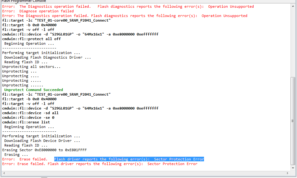

jagxin
Dear sir
               No one has replied yet we are able to connect now by using sram init.tcl file when we are trying to erase the nor flash we are facing the problem
of sector protection error how to solve this how to read the device id of the flash device
