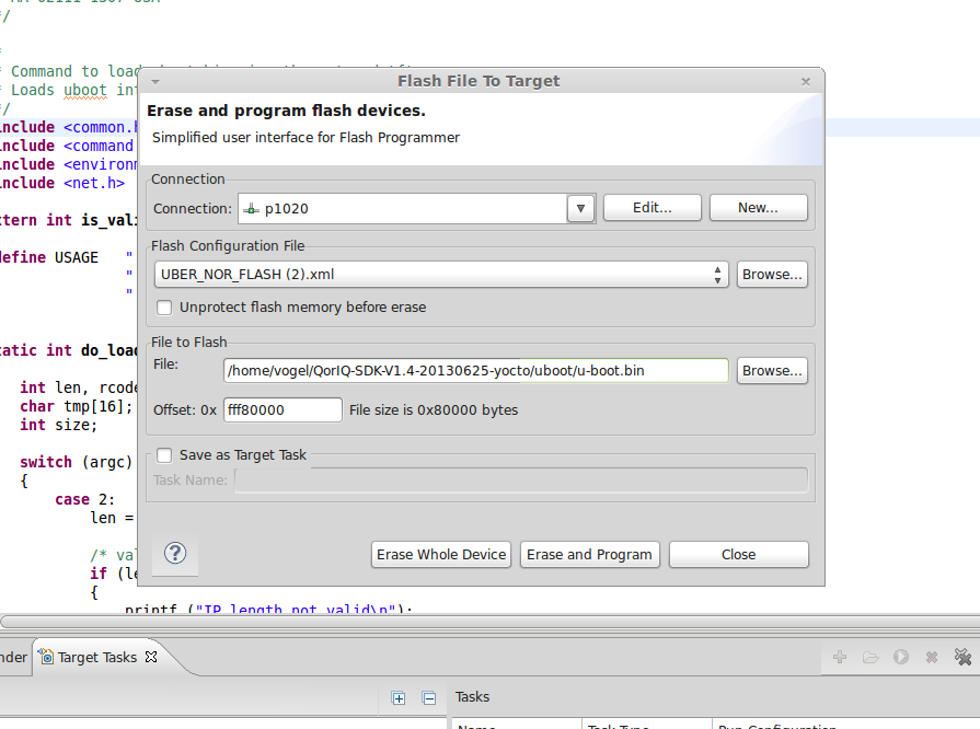

tomvogel
I seem to be missing something. The Simple Flash Programmer dialog I have looks like this:
My only options are 'Erase Whole Device' or 'Erase and Program'.
5,295 Views
addiyi
I referred to the second way of using Flash Programmer. Once you are in debug, go to Target Task view, import .xml file and open the task. Then add an Erase/Blank Check Action and instead of selecting Erase All Sectors Using Chip Erase Command, you can manually select all sectors.
