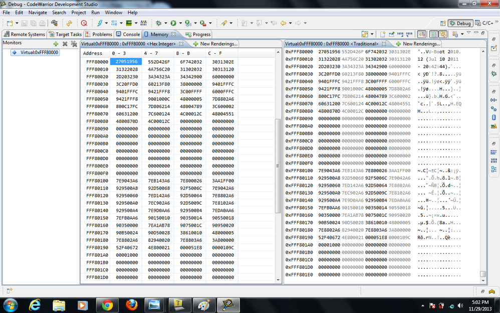

addiyi
The steps performed are correct. As you can see from the log Program with Verify Command Succeeded for both binary files. Additional, you can check using Dump Flash action (Dump region 0xFF7E0000 to 0xFF7FFFFF for first file and 0xFFF80000 to 0xFFFFFFFF for u-boot.bin) if the programming of the flash succeeded.

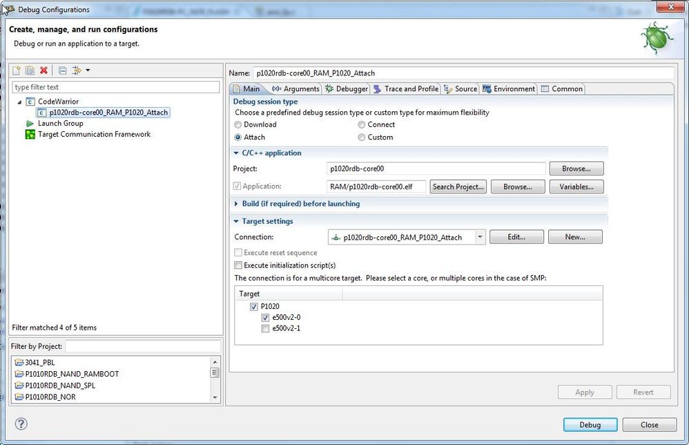

addiyi
I was able to program your u-boot on a P1020RDB board. Attached you can find some screen shots with steps that I have followed.
Switches on my board: SW2: OFF ON ON ON ON ON OFF ON; SW3: ON ON OFF ON OFF ON ON OFF

what is the run configuration
12,111 Views
addiyi
Run configuration that I used is Attach
Init file: P1020RDB_init_core.tcl and mem file: P1020RDB.mem

Nuevo
I used run configuration same has u used......... it got programmed successfully ......... and also got same memory view how u got.......... still board is not
bring up........... can u tell me what will be the problem..... how can i solve it.
12,111 Views
Nuevo
i used run configuration as NOR-FLASH-core00_RAM_P1020_Download  i also got the same what u got from memory view.... but still my board is not bring up.... unable to fix what is the problem
