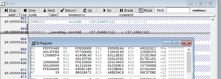

I have my boot code which after configuring SRAM TLBs etc. calls function for setting the IFC interface for the flash (which copies flash code to SRAM and execute it from SRAM).
Since it calls .c function I see that there are calls to save64gpr_27 (which I found out to be used for saving the stack data).
For some reason, when debugging and entering the assembly of this function, seems that getting an exception.
The function is implemented in the libc_E500V2.a

yoavbaryoseph
Updated, and still same issue as you can see in the following capture:
after the line 864 is executed PC jumps to 0 address.
r11 = 0x4013FF60 = SRAM (256 KB, starting at 0x4013FF60, so it is in the range)
So no exception should occur.
However, why the save64_... function use this address, is there any way to change it?
Stack is defined in different address (-stack option in the compiler set through the IDE)
I can extract any other information which may help.
Yoav

carver_ua
I had a similar problem in the simulator.
this topic helped me.
https://community.nxp.com/t5/MPC5xxx/the-instruction-of-evstdd-generate-an-exception/m-p/987374/thre...
Register.Set SPE 1
/carv

yoavbaryoseph
TLB is set properly - also I can see all SRAM range with the Lauterbach.
I think there may be an issue with the "evstdd" instruction implemented by the save_gpr command. (how the e500 library compiled).
As far as I know, the P1010 has no floating point, when I set the project to be without floating point I get a warning that the library settings of the floating point are not the same as the project.
It seems that the "evstdd" instruction is relevant when floating point is available.
Am I correct? maybe I need to use a different library?
Or if I am mistaken - maybe I have to set tome registers in the core to enable those instructions?
Yoav
