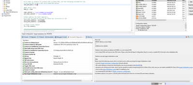

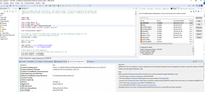

Kavinravi
While bringing-up LS1046A-based custom board using CodeWarrior, we encounter “Memory access failed” error.
As shown in the target initialization file, we set the USE_SAFE_RCW = True; But, we got: Memory access fail.

When we set the USE_SAFE_RCW = False:
We got “RCW error encountered. In order to diagnose the error temporarily change the board configuration switches to ignore the assertion of the RESET_REQ_B signal. Please refer to board reference manual in order to locate the appropriate switch that controls this behaviour.
Could someone please help us to resolve the error?
Thank you for your support.
Kavin
