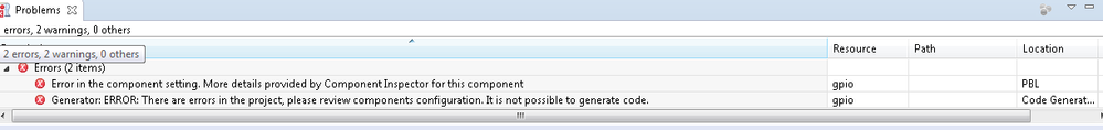

I am trying to import the default pbl file that came with the SDK for the LS1012A-RDB named PBL_0x35_0x08_800_250_1000_default.bin. When I import it into the CodeWarrior configuration tool and try to generate the code from the default pbl file I get the following errors:
I look in the Component Inspector and there is no errors that I can see. Has anyone else been able to generate the default pbl file again in CodeWarrior?

You should activate Ignore Constrains and non-Critical errors as in the below image

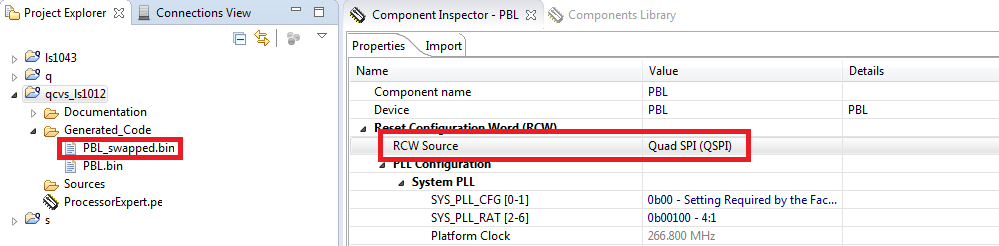

I can now generate the file from the original but it looks like the opposite endianness. Do you know how to change the endianness or what endianness and output format the pbl should be in (i.e. binary, object dump, etc.)?
2,968件の閲覧回数
addiyi
By default QCVS will generate the PBL image in the SoC endianness. For LS1012 QSPI boot location, PBL can be generated swapped by selecting RCW source = Quad SPI (QSPI)
