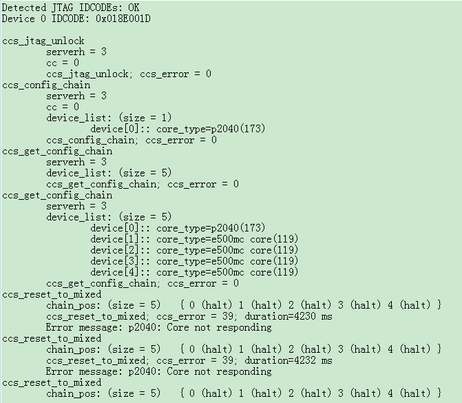

I have tried the first method, but it is invalid.Then I first show you the ccs log:111.png
7,572 Views
yipingwang
Hello lianying,
Did you use CodeWarrior JTAG configuration file to override RCW on the target which I mentioned previously? Why I didn't find CCS writes RCW related registers in the CCS log? Or did you use hardcoded RCW?

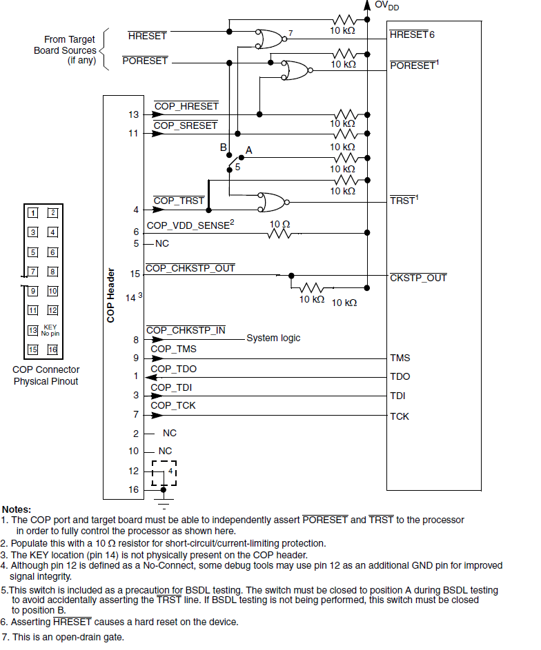

hello Yiping Wang,i found that my board's JTAG interface Connection seems to be Incorrect.2.png1.png
222.jpg.
The pictures above is from the evaluation board's material.the pwr_hrst_n signal is produced by the MAX6370,right?but unfortunately,my board hasn't the watchdog timer,there are other solutions to make up it or i must add a WDT?

1. Please check whether no problem with the CodeWarrior (USB) TAP, do you have a demo board to verify the TAP?
2. Please check JTAG interface hardware design on your target board, please ensure HRESET not tied to TRST, HRESET exclusive to COP/JTAG header.

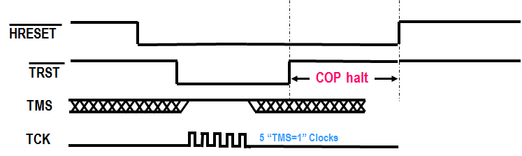

In your CCS log , there is no problem to get the configure chain to set up the basic connection to processor, it failed at ccs_reset_to_debug, so I suspected there was problem with HRESET and TRST. COP debugger needs the ability to drive HRESET and TRST independently, please refer to the following timing wave form.
Critical timing for USB TAP is the trailing edge of the HRESET* signal. TRST* must be negated in time for USB TAP to send several COP commands to the processor before HRESET* is negated. Processor control problems occur when the TRST* follows HRESET*.
With TRST* asserted, the JTAG lines are held in reset. This means the JTAG lines cannot be used to send COP commands to the target processor.  If the target processor does not receive the COP commands designed to stop when HRESET* is negated, the processor will begin executing target code instead.
So I suggest you check HRESET and TRST according to the above JTAG connection diagram.

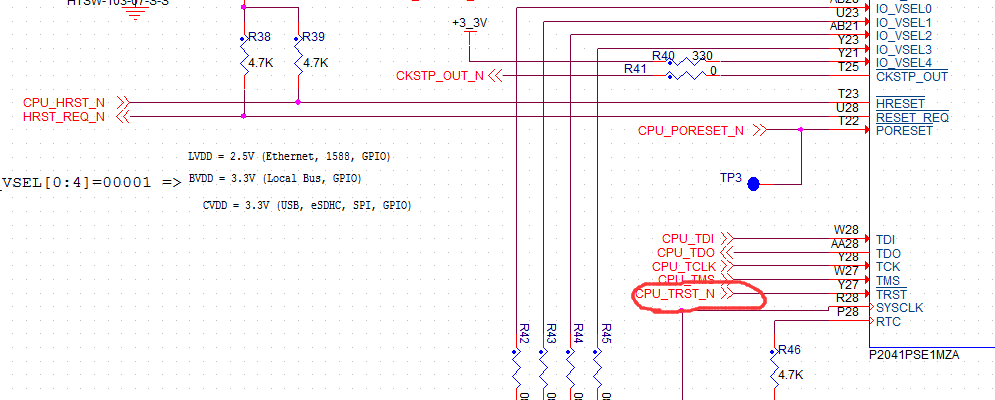

连营张
Fresh Out Contributor
hello,Yiping Wang,The above two pictures are respectively JTAG's interface and cpu.The top picture’s several reset pins(COP_TRST_N,COP_SRST_N,COP_HRST_N) are all connected to PIC Microcontrollers,while cpu's CPU_TRST_N pin is also connected to  PIC Microcontrollers,they aren't connected directly to each other.if it is like this,how the jtag can reset the cpu core?it is the reason that leads to" failed to reset the target,core not responding"?Looking forward to your reply!
