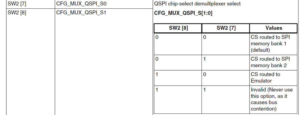

I want to reprogram u-boot in the QSPI flash of my LS1012A RDB, but would like to try out the new version in the second flash bank before overwriting my primary bank. Is it possible to use the CodeWarrior flash programmer for programming bank 2, or is it better to use the U-Boot shell for this? E.g., using the following sequence from the QorIQ SDK manual...
=>i2c mw 0x24 0x7 0xfc; i2c mw 0x24 0x3 0xf5
=>tftp 0x80000000 <u-boot_file_name>.bin
=>sf probe 0:0
=>sf erase 0x100000 +$filesize
=>sf write 0x80000000 0x100000 $filesize
=> reset
Because CodeWarrior's flash programmer tool makes no mention of the flash banks, and I don't know what sort of reset it performs before reflash, I'm afraid that even if I send the i2c command from the shell prior to reflashing, the target may revert to bank 0 before the flash erase/program commands are sent. I've verified that neither the reset command in the U-Boot shell nor the reset push button on the LS1012A RDB front panel causes revert to bank 0. Also, simply connecting to the target in CodeWarrior does not cause revert to bank 0. But again, my worry is that I don't know what sort of reset, if any, is performed as part of the flash reprogramming sequence...

Hello Brett S,
Please refer to the following switch setting of LS1012ARDB to configure CS routed to QSPI bank 2, then use CodeWarrior to do flash programming.

Yiping,
How does this interact with the i2c commands for switching between the QSPI
banks? Will the i2c command be ignored if the dip switch is used to select
bank 2?
