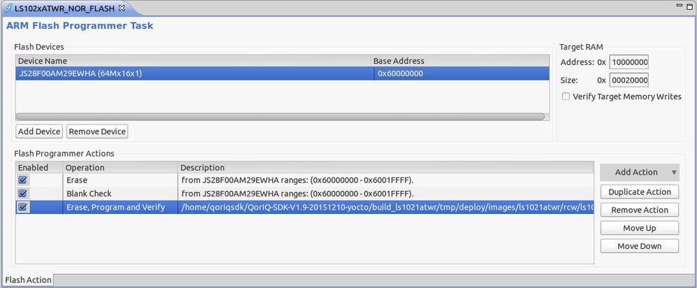

I can also use the Target Tasks to import LS102xATWR_NOR_FLASH task and successfully run erase and blank check tasks on the NOR flash, but the program/verify task fails:

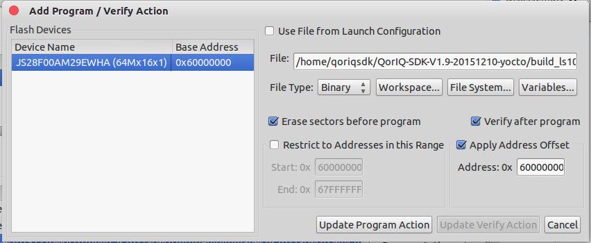

Here is the detail settings for the Erase/Program/Verify action:
And the error that I get in the flash programmer console is shown here:

fl::target -lc "Power1021Bare-core0_RAM_LS1021ATWR_Download"
fl::target -b 0x10000000 0x20000
fl::target -v off -l off
cmdwin::fl::device -d "JS28F00AM29EWHA" -o "64Mx16x1" -a 0x60000000 0x67ffffff
cmdwin::fl::device -sd all
cmdwin::fl::device -se 0
cmdwin::fl::erase list
Beginning Operation ...
Performing target initialization ...
Downloading Flash Device Driver ...
Reading flash ID ...
Erasing Sector 0x60000000 to 0x6001FFFF
Erasing ...
Erase Command Succeeded
cmdwin::fl::blankcheck list
Downloading Flash Utility Driver ...
Performing Blank Check from 0x60000000 to 0x6001FFFF ...
Blank Checking ...
Blank Check Succeeded
Blank Check Completed Successfully
cmdwin::fl::image -f "/home/qoriqsdk/QorIQ-SDK-V1.9-20151210-yocto/build_ls1021atwr/tmp/deploy/images/ls1021atwr/rcw/ls1021atwr/RSR_PPS_70/rcw_1000.bin" -t "Binary/Raw Format" -re off -oe on -o 0x60000000
cmdwin::fl::erase image
Error:  Failed reading return status.  Can not read target memory at location: 0x000000001000000C.Please make sure that the chip selects are properly configured.
The CWPP response code is: CCSProtocolPlugin : CCS: Scan timeout.
Error:  Getting flash ID failed
Error: Failed reading return status.Can not read target memory at location: 0x000000001000000C.
I'm not sure how to resolve this issue. Any help would be greatly appreciated.

According to your log, it looks that there is problem in the DDR controller configuration section in the initialization file. I suggest you use OCRAM on the target to execute flash programmer algorithm. When you create a bare board project, please select "Download OCRAM" or “Connect OCRAM" Launch configuration in "Debug Target Settings" panel, then use OCRAM launch configuration to connect to the target board to download the Flash Device Driver to OCRAM. This method would help you to avoid using DDR memory to overcome the problem which you are encountering.

Thank you Yiping and Adrian I was able to get the NOR flash programmed. Here are the exact steps I took:
1. Power up the board with the CPLD setting the IFC_AD[15:8] lines to 8'b01110010; This will tell the CPU that hardcoded RCW is disabled and prevents the power up sequence from trying to access the NOR flash. (I did this using an input flag to the CPLD equivalent to SW2[2])
2. In the CodeWarrior, start a new BareBoard project and select the Connect OCRAM as Launch mode for the target settings:
3. Build the project.
4. Start the debug process by clicking the debug button in the debug configuration window accessible under RUN menu.
5. After the Debug process started with successful connection to the board, click the resume button so the code is executed:
Steps 6 to 9 can be completed in advance or once, before debug session is started. For reuse of the method, these steps can be skipped if target task is already setup.
6. In the Target Tasks window, add a new task under Root with task type set to ARM Flash Programmer and Active Debug Context as its Run Configuration.
7. Add the NOR device ( I had to make a new XML file for our NOR flash as CodeWarrior did not have the one we had used and add it to the product-manifest.xml file also. Follow the instructions in AN4349 Adding Device(s) to the CodeWarrior™ Flash Programmer for ARM™ V7
8. Set the correct base address for the NOR flash and Target RAM address and size ( based upon the SDK documentation section: Deployment Guide>Boards>LS1021ATWR>System Memory Map). Note that the RAM size has to set to 64K since only one of the cores will be active.
9. Add flash programmer actions of Erase, Program and Verify for RCW and U-boot from the SDK or based upon QorIQ Configurator at proper offset on the NOR flash  ( based upon the SDK documentation section: Deployment Guide>Boards>LS1021ATWR>Flash Bank Usage).
10. Click the Execute button in the Target Tasks window:
and the flash will be programmed:

Check the init for DDR and OCRAM, and use as Target RAM address in LS102xATWR_NOR_FLASH task the correct address for OCRAM or DDR.

Thank you Adrian. I was able to follow Yiping and your instructions to get the NOR flash programmed. My target RAM address was correct (0x10000000 for the OCRAM) but the target RAM size was not correct. Since only one of the cores is being used, I can only use OCRAM0 for which the size is only 64K (0x10000) and not 128K (0x20000) as the documentation points to. I'll post my final results here.
