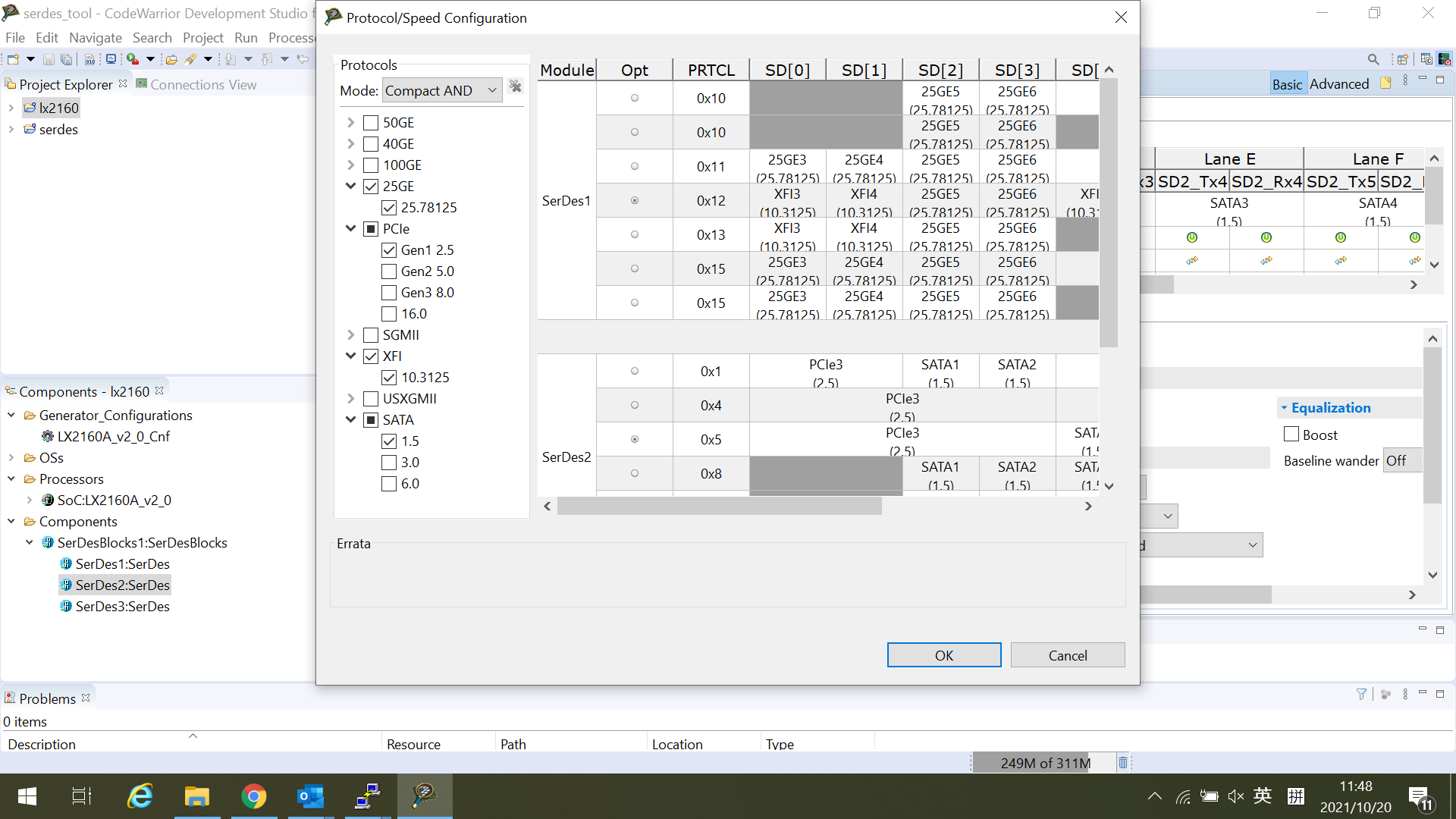

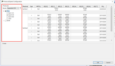

my custom board is lx2160a,serdes2 protocol is 7.
Click the Change protocol and speed configuration button
The figure below presents an overview of the Protocol/Speed Configuration window。
The protocol content in red box seems incomplete, no SGMII, USXGMII,it is Normal?

Please download the latest com.freescale.armv8.11.5.5.GA.Win.updatesite.210930.zip release from the following link.
链接: https://pan.baidu.com/s/1pC7eL1SWVruepofVwEedcg
提取码: nt2r
Then install it in CodeWarrior IDE from Help->Install New Software->Add->Archive.
Please refer to my attached screenshot.

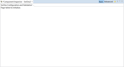

after update

Hello muaxi8,
Has the problem "Page failed to initialize" been resolved?

No solution, but I don't need this function anymore。
5,183 Views
yipingwang
Do you use Chinese edition Window 10 OS? It seems that QCVS serdes tool isn't compatible with Chinese edition Window 10 OS.

Please create a new project in the new workspace.
