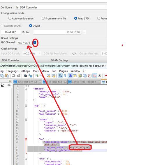

yipingwang
Below are the parameters related to I2C that are used by QCVS.
To enable different I2C mux you can select checkmark from wizard and put desired I2C mux. Right now, the value “0x77 0x76” is used.
Another way is to edit the .json file below and put your custom parameters.
C:\Freescale\CW4NET_v2020.06\Common\QCVS\Optimization\resources\QorIQ\ARMv8\templates\ddr\ system_config_params_read_spd.json

shivam_kumar

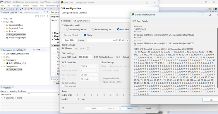

We have implemented the changes and modified the ''i2c_mux_ch_default" in .Json file settings to align with our multiplexer configuration. As a result, SPD read is now functioning successfully, and we have attached a snapshot of this progress.
However, after creating the project, In the Component Inspector SPD section, there is no data, and it shows a message stating, “No SPD data found for the selected DDR component.”. Is this an issue for ddr configuration?

yipingwang
After click "Read SPD" button in "DDR configuration" panel, please click the green PASS icon, and check whether you can get data similar as the following.
If cannot, please use oscilloscope to measure I2C multiplexer input and output, whether they are normal.

shivam_kumar
I have successfully completed the suggested step and can read the SPD values by clicking the green tick mark. I’ve also attached a snapshot of this. However, the SPD section in the Component Inspector does not display any values. Additionally, I am uncertain about the required modifications in the ddr_init.c file and the procedure for compiling the files generated from Processor Expert code into bl2_sd.pbl using BitBake. Could you please clarify?
