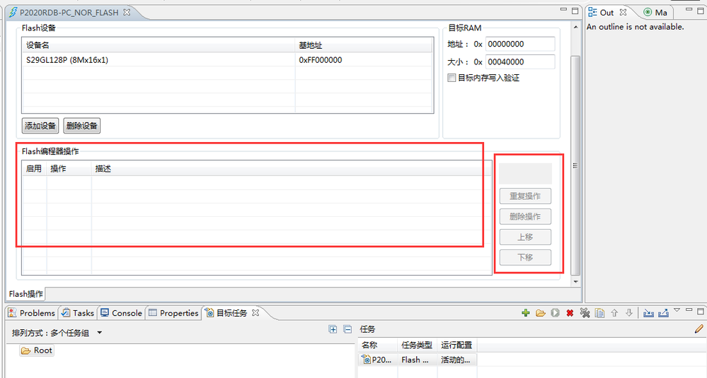

We have installed CW10.6.4 and setup the FLASH Programmer as a Task. But the flash programmer actions is not activated. like that:
How can I do that!!!

Hello Lw,
Please install CodeWarrior for PA 10.5.x for QorIQ processors.
There is compatible problem between Chinese edition OS and CodeWarrior, please try the following workaround.
1. I suggest you reinstall CodeWarrior 10.5 in an English edition Window PC if possible.
2. Please change theme of OS, please refer to "4.3.1. Usage Notes and Limitations(Ubuntu Themes)" section in the release note CW_PA_v10.5.x\PA\Release_Notes_PowerArchitecture.pdf.

hello, YipingWang, thank you for answer my question.
my host pc os is win7 x64 Chinese edtion
