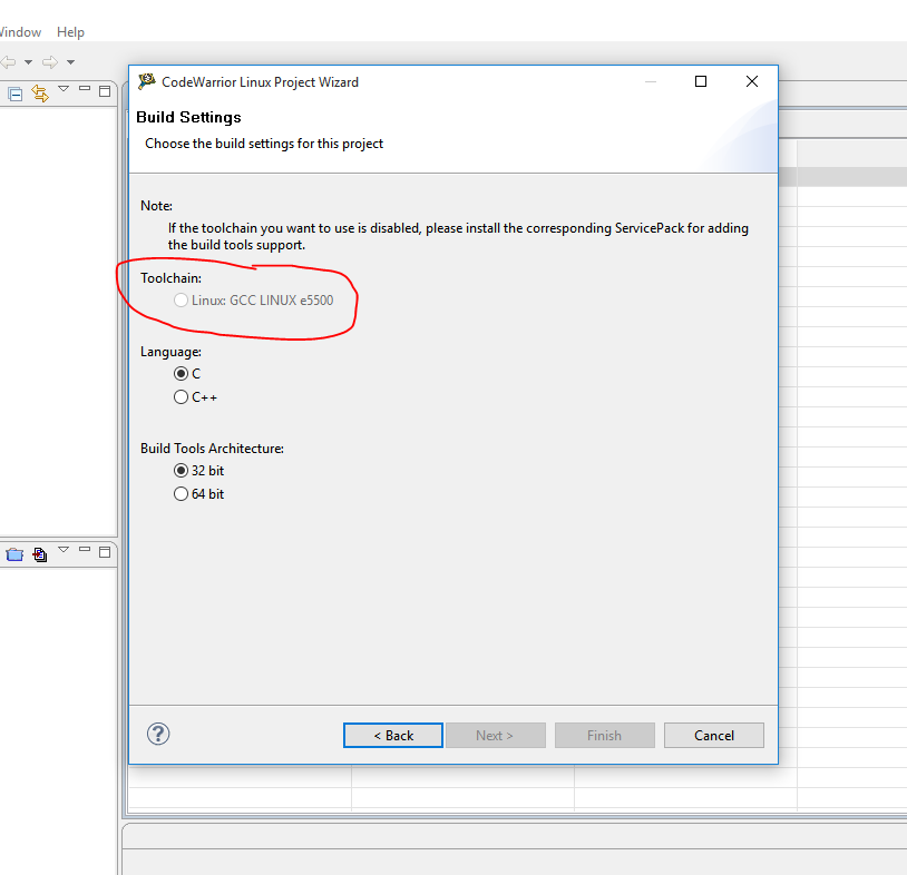

I am using Codewarrior for Power Architecture version 10.5.1. Kindly answer below questions ?
1) Is it latest version ?  (Screenshot  below)
2) Is  "Codewarrior for Networked application" applicable for T1024  ?
2) I also installed plugin named as "GCC.Aarch64.LinuxApp.Win.updatesite_b4.9-nxp-2016.03.03_170220.zip"  .   Still I cannot create a linux project because the selection button is disabled. What can be the reason ? (Screenshot  below)

Hello Abhishek,
CodeWarrior for PowerPC 10.5.1 is the correct version for T1024.
Please install the Service Pack for Linux application with online method in CodeWarrior IDE from Help->Install New Software, please click "Available Software Sites" and select "FSL PA Build Tools", please click the drop down list to select "FSL PA Build Tools - http://freescale.com/lgfiles/updates/Eclipse/PA10_5_1/com.freescale.pa.buildtools_win" at Work with, please check "PA GCC LinuxGNU Build Tools Service Packs" to follow the install wizards to install this service Pack step by step.
