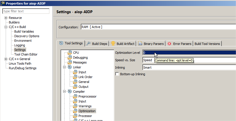

I added some auxiliary steps to avoid using of the CW for ARMv8 (keeping just CW for APP) and the problem should disappear now. Please use the attached AN.
Also, I just bitbake -ed the application, not added/modified the recipe - please note that the debug symbols are added by default. Also, I recommend to build the app with CW and to set the optimization level to -O0 (Project Properties > C/C++ Build > Settings > Compiler > Optimization > Optimization Level 0)
