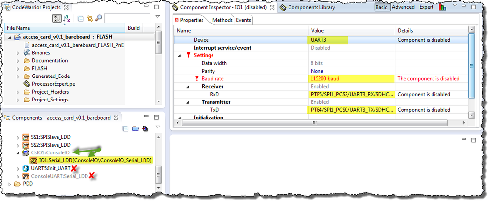

Hello Mehdi:
I looked again at your project and detected that you are missing some settings. You added a second Serial_LDD component, but there is already one when you add the ConsoleIO component. You just need to configure that one to your needs (UART0, PTB16, PTB17 and baud rate). This Serial_LDD is hidden below the ConsoleIO component. Check the next picture:
However, all this is explained in the tutorial from the link. Let me know if you still have problems.
Regards!
Jorge Gonzalez

Jorge_Gonzalez
Hello Mehdi:
I checked your project. If you already have the ConsoleIO component, then there is no need to add other UART components. You can find a well explained and detailed tutorial in the next link:
Tutorial: Printf() with (and without) Processor Expert | MCU on Eclipse
That tutorial is for Freedom KL25 and using GCC tools, but procedure is the same for your K10 and Freescale build tools.
Regards!
Jorge Gonzalez
