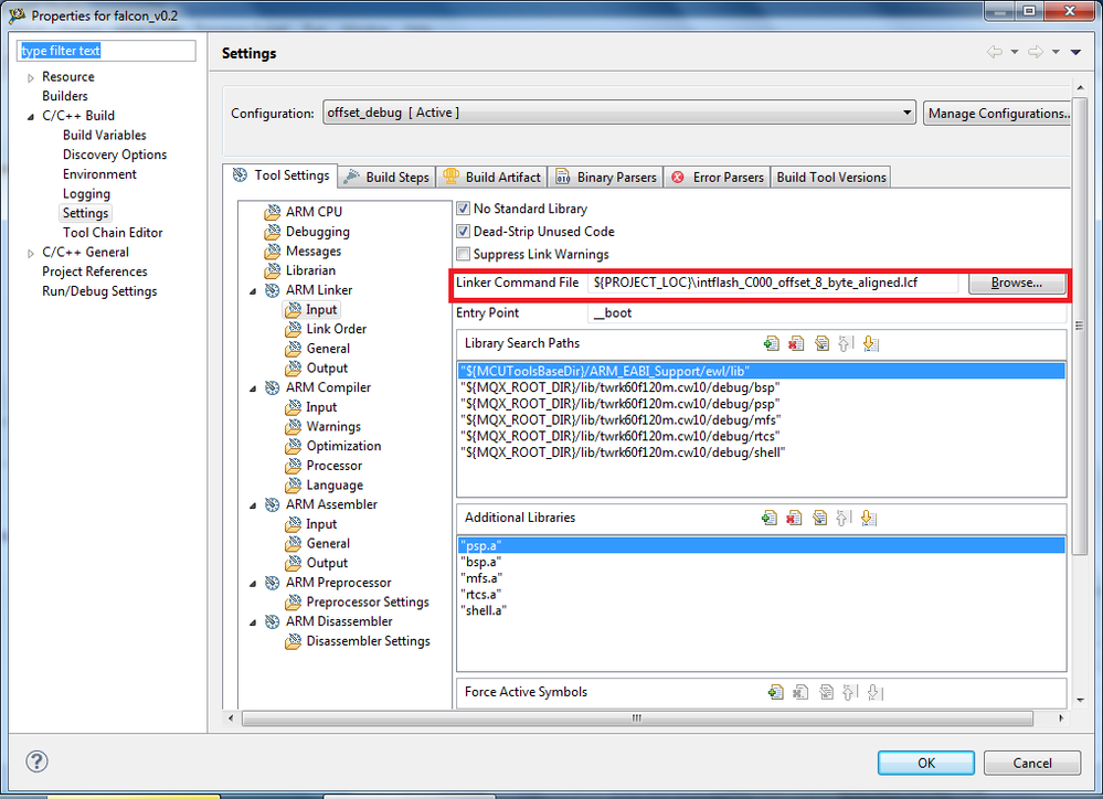

Hello Community,
I try to change the linker file for my project in CW 10.6. In CW 10.5 I could do it by browsing to my 8.lcf file as follows:
but I don't see the same option in CW 10.6! Would you please let me know how can I do that in 10.6.
I use K60F120 and MQX 4.1

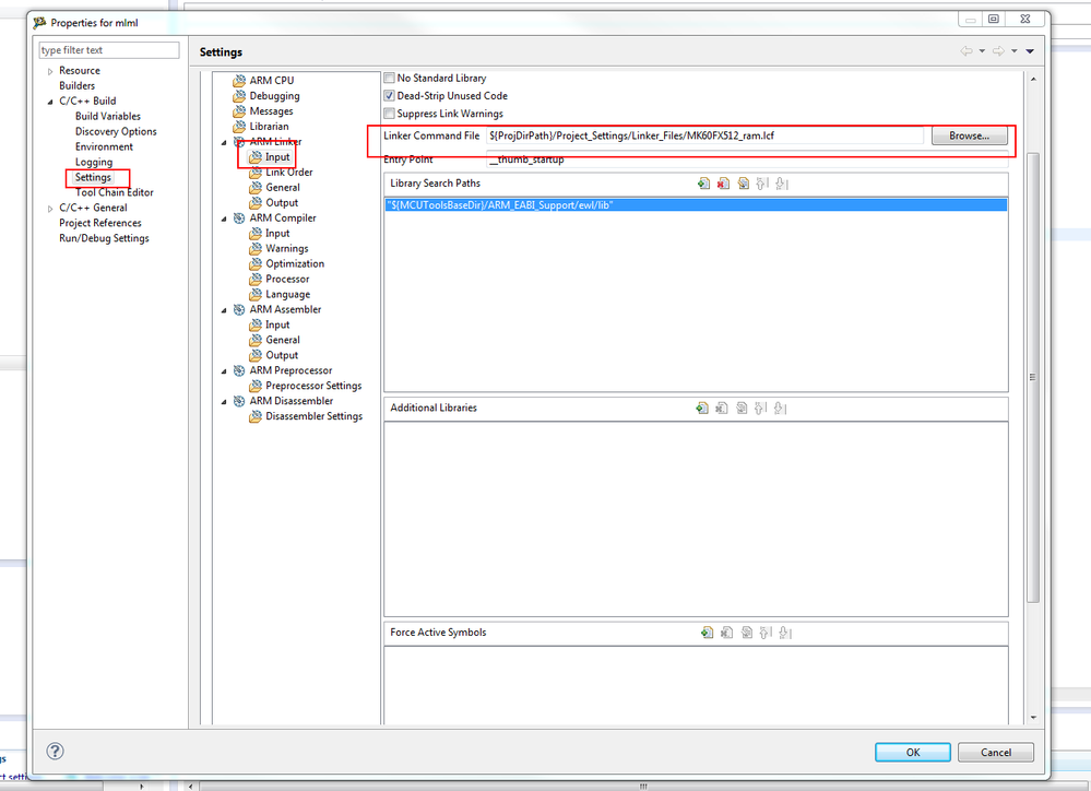

Hi S M,
In  CW 10.6
Alice
