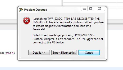

I have TWR-S08DC-PT60 demonstration board for MC9S08P family. How do I use codewarrior for this particular family? I found the quick start guide and installed the software but the process explained is not working. When I debug the IDE stops working. What can I do?
EDIT1:-
Added images of the errors that keep on appearing on the screen.
I think that it is some error related to the USB cable that I am using. Am I correct?
What USB needs to be used with this board?
Message was edited by: Aseem Bansal

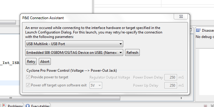

Added more information regarding the problem. Someone please tell if more info is needed to find the solution.

This looks like a driver or firmware problem. First, make sure you have all of the service packs installed for CodeWarrior. Choose Help > Look for Software Updates and install those. Next, make sure you have the latest drivers from P&E Microsystems installed. They can be downloaded from www.pemicro.com Finally, use this forum thread that has a description of how to force windows to do a driver update.

I had the same problem with my TWR-S08DC-PT60. I couldn´t use the debugger after the first flashing. I reprogrammed the PT60 with an USB-Multilink and after that the OSBDM worked.  .
My PT60 board has the OSBDM Firmware Build 90 Revision 9. That seems a litte strange. I have a TWR-S08UNIV, wihich has Firmware Build 30 and Revision 21, this is the latest Download from P&E. This board has problems with OSBDM too.
You can enable console logging for the debugger to see what is going wrong. When I try to debug my S08UNIV, sometimes  the initial connetion goes wrong and sometimes after flashing the device the connection after the reset cant be established.
