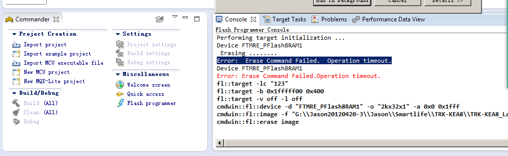

Hi  we used the CW10.5 with OpenSDA debug TRK-KEA8 boad, we used demo code on TRK-KEA8, it can goto dubug, but can't download the code into flash now.what't the problem? under the picture it the Erroe infomation.15939_15939.pngQQ图片2.png15938_15938.pngQQ图片1.png

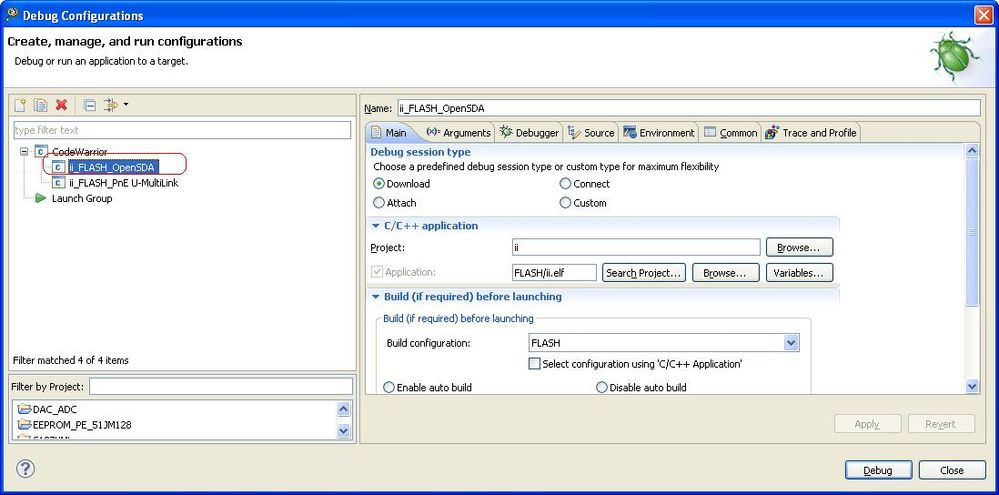

3. make sure you choose OpenSDA as debug interface.

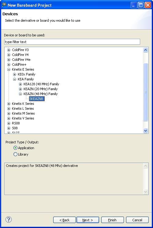

4. when create a new project, this is what I select:

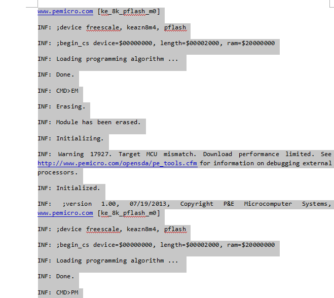

Thanks, Today I had download CW10.5. the error is same. also can run under the debug mode. after unplug and plug the USB, the soft is not run. the ERROR information is same as before like below. i check the SDA, it show like your picture.
Warning 17927. Target MCU mismatch. Download performance limited. See http://www.pemicro.com/opensda/pe_tools.cfm for information on debugging external processors.
