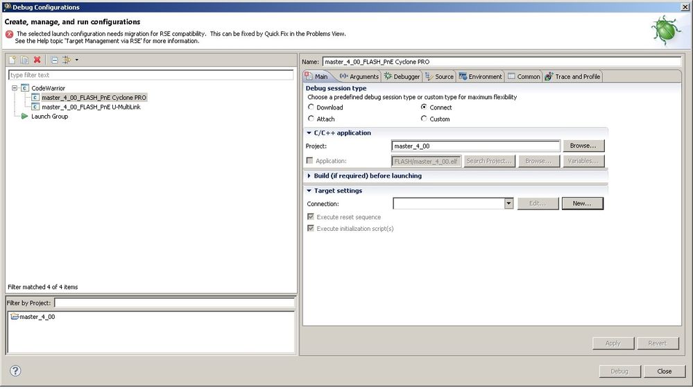

Hi all, I have installed codewarrior 10.6.4 on Windows 7 x64 and I'd like to connect to a MCU coldfire CFV1 MCF51JM128.
I am using a cyclone PRO emulator connected to USB port with driver 12.2.0.0.
I have created a new project and now I can build it, but I cannot debug.
When I attempt to edit "Target Settings" In "Debug Configurations" I don't see any device in "Connection", but my emulator is connected to PC and turned on. I am sure the emulator works fine because I can debug on another PC with Win XP and Codewarrior v6.2.

Hi Jennie,
my problem is that I cannot see devices in "Connection" within "Target settings" section.
Here the screenshot of my window of "Debug Configurations"

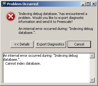

I have also encountered this message when codewarrior starts up:
I don't know if this problem can influence the debug session.
5,171 Views
ZhangJennie
you have "Indexing debug database" error.
1. I ever had one customer have similar problem as yours. he solved the problem by removing .metadata folder in the current workspace. then restart CW, check the problem again.
2. some other customers have this problem because lack of windows permissions. please make sure you have windows admin right when install and use CW. we have customers fix the problem by "Turns out that I had CodeWarrior installed in C:\Program Files (x86), and that was enough to break it. When I moved the install folder to C:\ it worked fine."
3. anyway, if the problem persists, please reinstall CW with windows admin right to a self-defined folder. create a new project in a new workspace. test it again.

Thanks ZhangJennie! I have solved my problem. I have installed codewarrior v10.7 under C:\ with administrator privileges and now it works fine.
