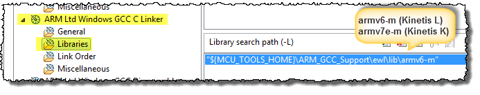

I'm getting this message: cannot find -lrt
context:
"C:\\Freescale\\CW MCU v10.5\\gnu\\bin\\mingw32-make" -j8 all
'Building target: Step1.elf'
'Executing target #22 Step1.elf'
'Invoking: ARM Ltd Windows GCC C Linker'
"C:/Freescale/CW MCU v10.5/Cross_Tools/arm-none-eabi-gcc-4_7_3/bin/arm-none-eabi-gcc"    @"Step1.args" -o"Step1.elf"
c:/freescale/cw mcu v10.5/cross_tools/arm-none-eabi-gcc-4_7_3/bin/../lib/gcc/arm-none-eabi/4.7.3/../../../../arm-none-eabi/bin/ld.exe: cannot find -lrt
collect2.exe: error: ld returned 1 exit status
mingw32-make: *** [Step1.elf] Error 1
It seems to have started after I loaded updates to 10.5 (which also broke CTL-X, CTL-C etc).
I did setup my project for no IO since I use my own tiny printf. I did check and the library selected is: ewl_noio
Any other ideas?

Hello Simon:
This might be caused by a missing library search path. Please check this:
Go to Project -> Properties -> C/C++ Build -> Settings -> ARM Ltd Windows GCC C Linker -> Libraries, and make sure that you have the path to arm libraries.
You don't say but if using Kinetis K device the path ends with armv7e-m, but if using Kinetis L, the path ends with armv6-m.
Hope this solves the issue!

This does solve the problem, but why do the lib paths suddenly disappear? I did not import or change version, I just started getting this error.
It's hard to make progress with  disruptions.
This is a bug in 10.6:
"Lib paths get cleared for no apparent reason"
For a K64 project you will need:
"${MCUToolsBaseDir}/ARM_GCC_Support/ewl/lib/armv6e-m"
"${MCUToolsBaseDir}/ARM_GCC_Support/ewl/lib/armv7e-m"
"${MCUToolsBaseDir}/ARM_GCC_Support/ewl/lib/armv7e-m/fpu"
If you have a RAM version of the project, you can copy from there or create a new project and copy them over if these are not right for you.
