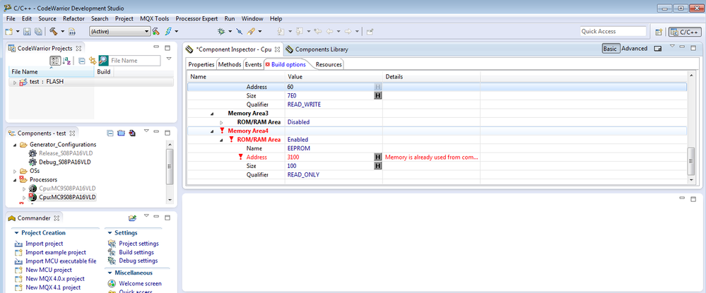

           I'm trying to use bean IntEEProm for MC9S08PA16 but when I put the address 0x3100 as a start adrress of EEProm the CodeWarrior gives me a error "Memory is already used for the component CPU".
          What's the problem?

By default when you create a project through the wizard for S08PA16 with Processor Expert (PE), PE will generate the linker parameter file (.prm).
The EEPROM module is already defined for the prm:
After to added the Bean
      Component: IEE1 of type IntEEPROM
      Description: Internal EEPROM
You must modify the Memory mapping.
So I've disable the Memory Area4.
Now the error disappears and I can generate PE code and build the project without problem.
