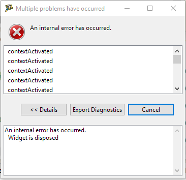

Getting this error when launching the debugger and also while the debugger is running.
Started happening after I coded in my own Uart support routines. All tty and itty #defines in user_config.h are == 0 and libraries have all been rebuilt.  Basically stripping out non essential bloat in MQX and just need the basic time slicing and stacks from RTCS. Debugger runs fine....just shows this recurring dialog box that won't go away.

Hello Phil Roth,
Please tell us which chip do you used? Also the debugger and CodeWarrior version,

Alice,
It's a 52259.  Debugger is P&E Multilink Universal FX BDM
CodeWarrior for MCU
Version: 11.0
Build Id:170926

Hi Phil:
Under Codewarrior, you need to set a default io channel (BSP_DEFAULT_IO_CHANNEL in user_config.h) betweem the client and host during a debugger session.
