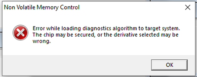

Hello Team,
Currently I am using
CodeWarrior® Development Studio for HCS12(X)5.2
for developing assembly language code and flashing the MC9S12A256 microcontroller.
I am stuck with the below mentioned error when I click on Debug in the IDE
Query 1: Kindly suggest me how to program or debug the MC9S12A256 microcontroller?
Query 2: Kindly suggest me how to unsecure the chip and run in debug mode?
Query 3: Kindly suggest me how to generate a .hex file after the compilation of the assembly language code in the Code warrior IDE?

Hi Jeevan,
If your problem is because of unsecure, you have to do the following: once the Hi-Wave is open, click on "P&E Multilink/Cyclone Pro" and then click on the "Unsecure" option. This will execute the command file designed to unsecure the microcontroller. All the flash of the device will be erased and the security byte will be set to the Unsecure status (1:0 in the security bits).
If this does not work go to www.pemicro.com , click on the support link and then Downloads and Documentation. Select “Utility” as the Download Type and HC(S)12 as the Product Family. On the available downloads( http://www.pemicro.com/support/download_processor.cfm ) look for the Unsecure12 Utility, download it and install it. This software will allow you to unsecure S12 derivatives we have.
