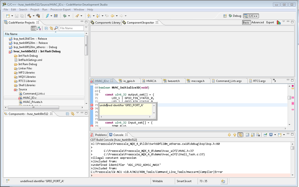

I'm getting a compiler error where the compiler says that it has an undefined variable, yet the IDE is able to find it through "Open Declaration".  All of the include paths seem to be intact, but the compiler errors on the same variable.

Could you post the exact error message? Which compiler/target?
I recommend that you generate a preprocesing listing: I guess there is something wrong with your includes, or with the defines.
The fact that the IDE does not find the declaration too really could mean that your includes are not correct.

The IDE DOES find the declaration.  That's what's confusing.  Here's a screen capture of the error after the compile:
I'm  trying to figure out how to get the pre-processor listing (still new to Code Warrior).
Thank you.

ah, sorry, I thougth the IDE was not able to find it.
Preprocessor listing: you should be able to right click on the source file, and the context menu should offer you that.
Maybe the order of includes is the problem?

Interesting.  I right clicked on preprocess, it ran the preprocessor, and the errors were removed!  So I ran the build, and they're back!?  To add another level to the confusion, this project compiles, but won't link, under RAM, but not FLASH (hvac_wifi).  I haven't changed the include file order from what it was when shipped as a Freescale example.  The hvac_wifi example appears to be written for the K60M100, and I am building it for the K60M120.  The startup code for the M100 would not work for the M120.  It hung on the PLL setup.
When I ran the preprocessor, the listing was output on the console.  After doing the build, it stopped outputing it on the console. ???

The preprocessor was a good suggestion.  I clicked on disassembly below it, and got an error I hadn't seen before.  It was a missing include path that kept me from including "verif_user_config.h".  It compiles ... now ... does it run?!?!?
Thank you.
