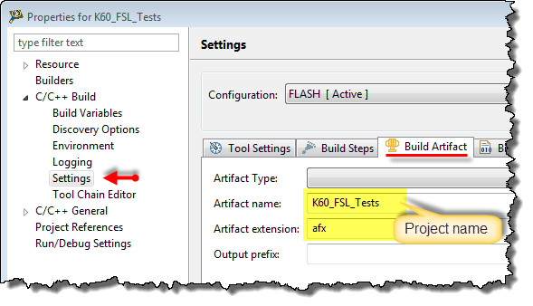

Also, please select your project and go to Project -> Properties -> C/C++ build -> Settings -> Build Artifact, and verify that you have something like the next:

      Thanks for your reply, Everything is set in the right manner. I am just doing a sample project and I am unable to create the .afx file or .elf file. If its possible, Can you send me any sample project with step by step screenshots which creates a .afx file or .elf file ?

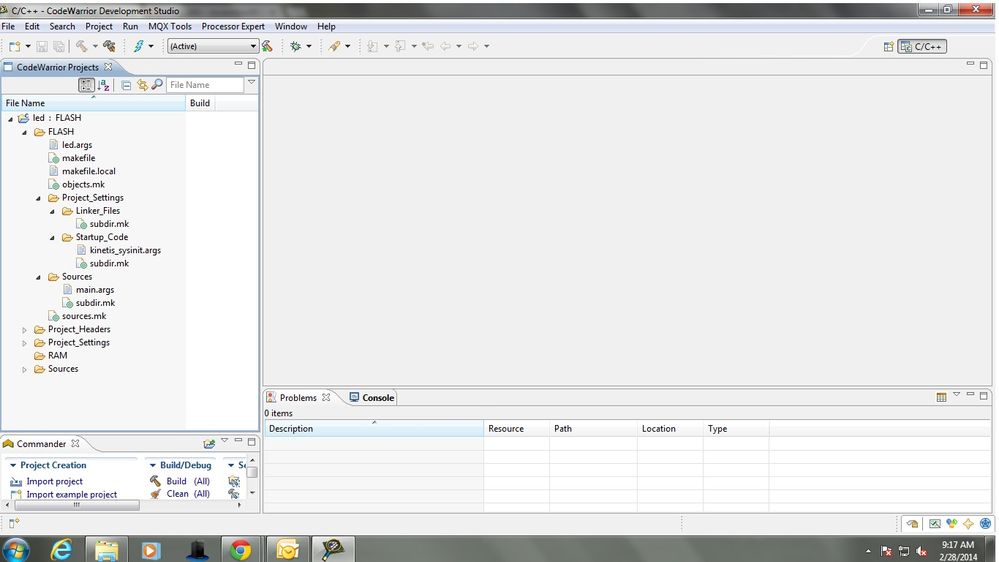

       Thank You very much I have done in the procedure of the video you shared, all steps are same and after building no binaries or .afx file are created. But every other files are created as in the video. What is the issue now ? Screen shot is attached for your reference.

Well, that is really really strange, so I have no answer, sorry. But off the top of my head:
    - Administrator (read/write) privileges over the CodeWarrior installation *and* the folder where your workspace is.
    - Workspace name contains special characters.
    - Try removing the .metadata folder or even better a new workspace (again, without special characters)
    - If you have antivirus, try disabling it temporarily while you build your project.
    - As last resource, I would go with a complete reinstall.
