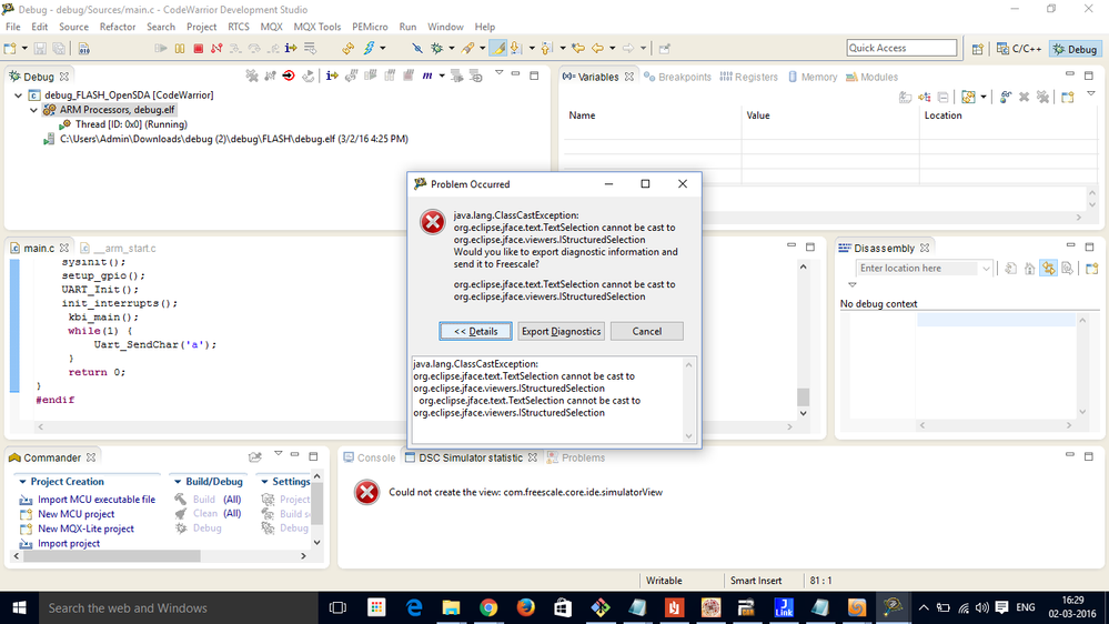

    I want to print messages on terminal.I am using UART as my default I/O interface.But i am not able to launch the terminal.It gives me this error.
I even Checked for software updates and did it but still the same.How to Fix this.

Hello VIGNESH,
The reason is the missing Low Level UART Support .
For the detail please refer to Tutorial: Printf() with (and without) Processor Expert | MCU on Eclipse
I also create one example for the TRK-KEA128 board on CW10.6 about the print use UART2, you can refer to it.
Hope it helps!

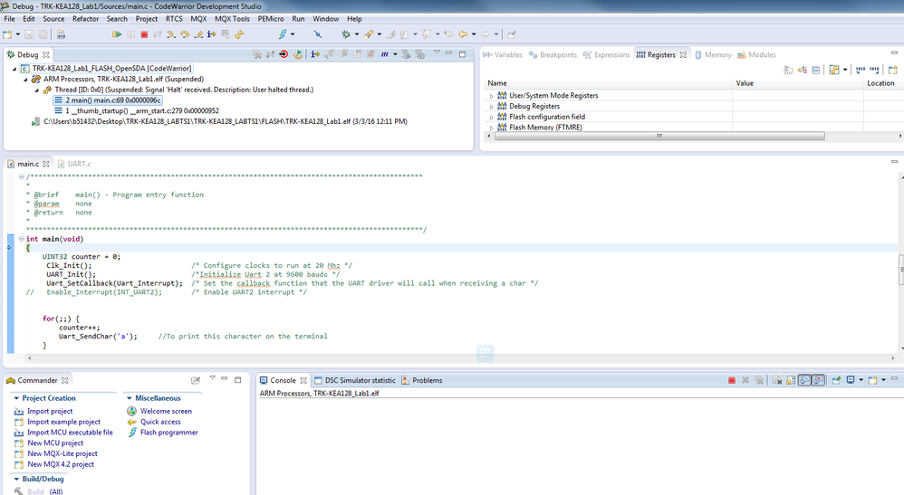

Hello ,
I have test your project on my side -CW10.6.5 , TRK-KEA128 board,  it can work well:
download:
after download :
run:
so there is no error whit the project .
Have you test the simple project on your side , what about the result , and what about your
board , demo board or custom boad?
Alice

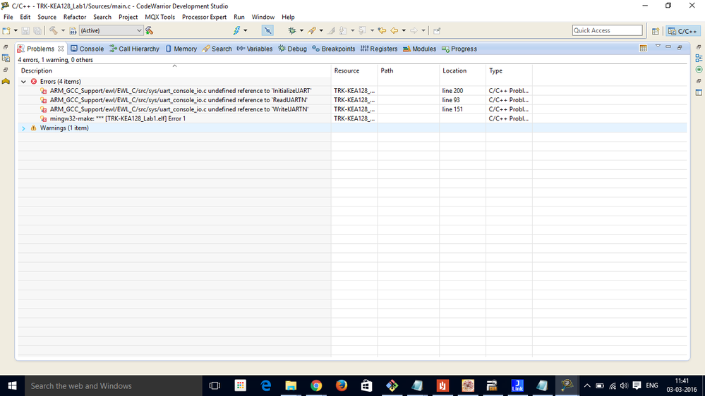

Hi Alice,
             Thank you.It is working in putty.How do I print messages by printf ???
How to print the messages in Printf?
