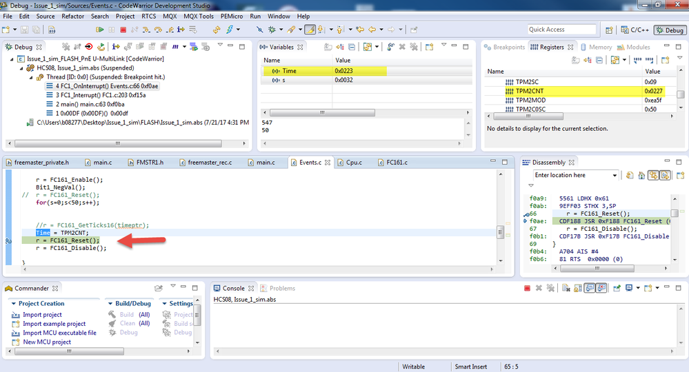

I am having a problem with time measurement in an application that I am developing using a S08SH. I am using (Processor Expert) FC1:FreeCntr with timer TPM10 to generate an interrupt every 5mS. This works fine. I am then trying to use  FC161:FreeCntr16 with timer TPM20 to measure a time interval: -
In the FC1:FreeCntr ISR I start the FC161 timer. A separate software event stops the timer and I read the elapsed time - except that it doesn't work.
To investigate the problem I created a simple simulation project.
void FC1_OnInterrupt(void)
unsigned char r,s;
unsigned int Time;
r = FC161_Enable();
for(s=0;s<50;s++);      // a simple delay loop
Time = TPM2CNT;      // read the ticks
r = FC161_Reset();     // set the breakpoint here
r = FC161_Disable();
The value in TPM2CNT was always wrong and the only it would work was if I set a breakpoint somewhere in the ISR and then manually changed registers TPM20SC from 0xD0 to 0x50 and TPM2MOD from 0x0003 to 0xFFFF.

ZhangJennie
Hi Julian
I finally found a board to test your project. here is my testing result
here, I set breakpoint at FC161_Reset()
in  Variable window: Time is 0x223
in Registers window: TPM2CNT is 0x0227
these two values are different. This is because the program runs from previous line to FC161_Reset() takes a few clock.
Please let me know what else you think abnormal.
