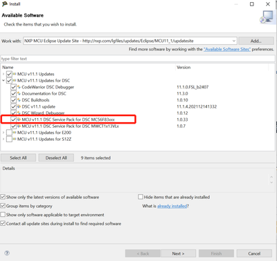

Working with CW 11.1, DSC 2.7.3 and MC56F83789-EVK.
The target MC56F83789 is not listed among the target choices that one would see in the "Debug Settings" -> Target->Edit-Target type. There is an option to import new targets, but where would I get these targets and what file extension am I looking for?

DSC service pack for DSC MC56F83xxx is included in MCU v11.1 updates for DSC.
Please go to CW IDE menu "Help", "Install New Software..." , install the update items I ticked.
Hope this will help you,
Jun Zhang

pgillaspy
Yes, that did the trick.  Consider problem solved.
