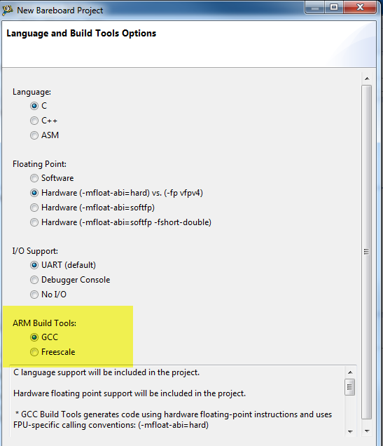

1 You can choose either ARM GCC or Freescale ARM compiler. But I recommend you use ARM GCC. You can select it with project wizard
2 Could you please specify what is “the compiler and assambler flags”?
3  Once you create a new project with wizard, you will see *.ld(ARM GCC) or *.lcf (Freescacle ARM) file under the project folder. This is the linker command line file.

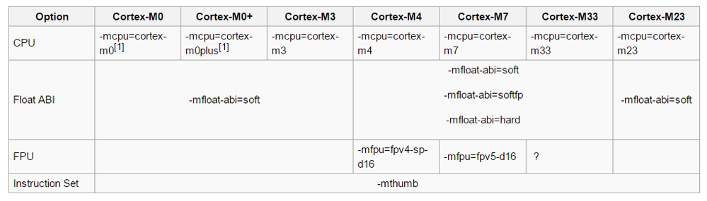

As you can see i need the Information about -mcpu, -mfloat-abi, -mfpu and -mthumb (for Cortex M4).
Where can i look for that information in codewarrior.
Perhaps the following always applies:
  • -mcpu = cortex-m4
  • -mfpu = fpv4-sp-d16
But what about -mfloat-abi? It can be soft, softfp or hard.

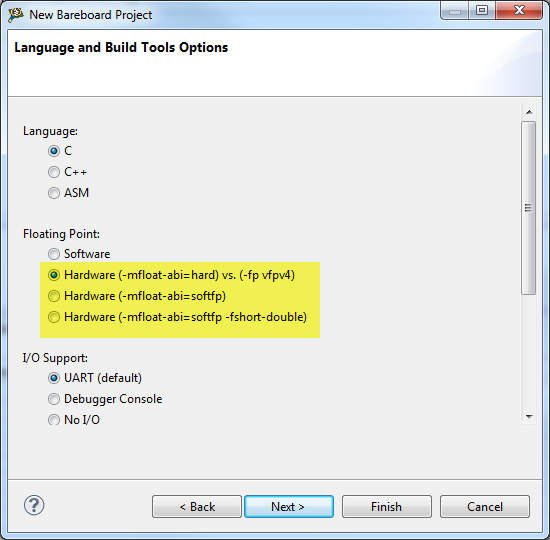

if we create a new project with wizard, we can see -mfloat-abi can be:

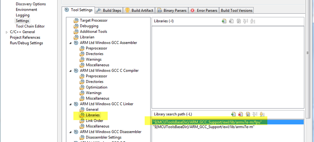

each of above selection is for different library. for example, -mfloat-abi=hard is for this library:

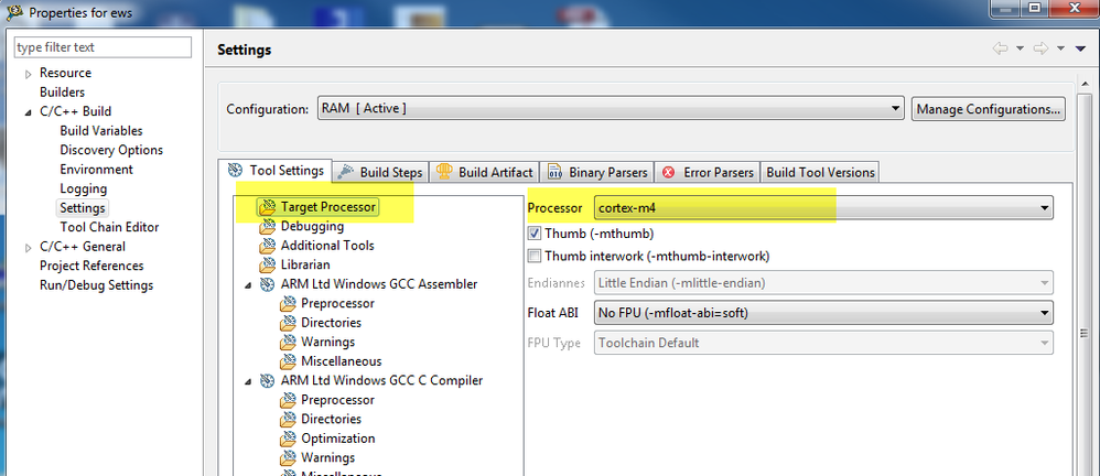

we can check the project target processor here:
