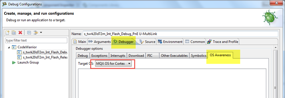

I am using CW  CodeWarrior for MCU Version: 10.6.4. The processor is a K65 running MQX 4.2.
The Window->Show\View->Components pane\window is empty.
In the debugger, the Stack Usage View pane\window has the following message:
Further information:
This view is used for viewing MQX performance data. To be able to view such data you need to enable kernel logging in your application and the either:
Start debugging the application; open this view and select Online mode in the view's menu.
OR
Start debugging the application; in the MQX (TAD menu) select Save performance data... to save performance data into a file; then open this view, select Offline mode and browse to the file you saved.
The MQX Task Summary is working so there seems to be some TAD working.

I wonder you didn't enable OS Awareness, please check if you enabled "MQX OS for Cortex", if not, please enable it before launch and try again.

Thanks for the reply.
Yes, the OS (MXQ OS for Cortex) awareness is enabled.
Any other ideas?

Hi Jim,
I just tested a demo code under MQX4.2 with CW10.7. On my side, I enable MQX_USE_LOGS and MQX_KERNEL_LOGGING  in user_config.h then rebuild psp. I can use Stack Usage View without problem
#define MQX_KERNEL_LOGGING                        1
#define MQX_USE_LOGS                              1
see attached video that I recorded from my computer. They are about online and offline mode separately.
Hope this helps!
