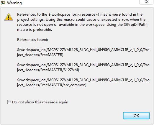

When I was using CW10.7, there was an image warning, and ${workspace_loc:xxxxxxx} was never found?
Please help answer,TKS!
1,284 Views
ZhangJennie
Build variable name “workspace_loc” was defined in project properties:
This message is just a warning, it’s not wrong.
There is no problem if your current project is under the workspace “workspace_loc”. However if the current workspace is not under predefined “workspace_loc”, the related references will not be found.
So we don’t suggest user use “workspace_loc” as path references. our suggestion is using the ${projDirPath} instead.
