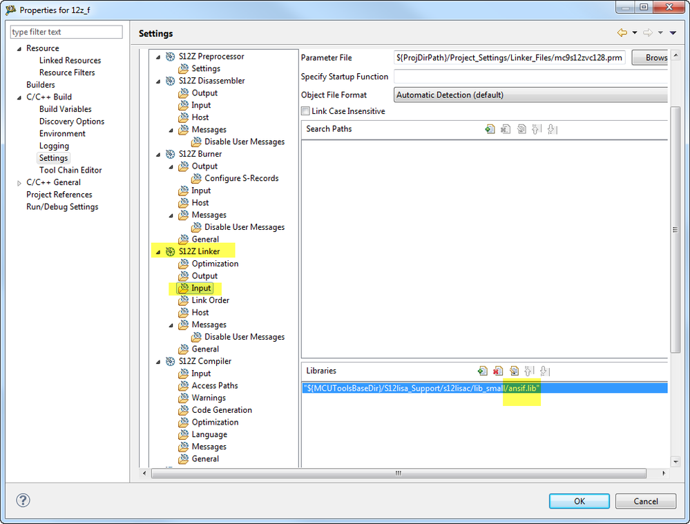

ahnjoseph
last,I had build project that was not to select  option of floating point
Now i need floating point calculation
so i want to modify project
i know it can new build project select floating point
But i need just modify last project
Can i this it ?

Dear Ahn Joseph,
I think I also handle one of your SR  1-3928133491 regarding to this question.
To switch project from non-floating to floating support, we need replace with the floating support library. See below screenshot:
All the S12Z library file is under this path: C:\Freescale\CW MCU v10.6.4\MCU\S12lisa_Support\s12lisac
  Can this help?
