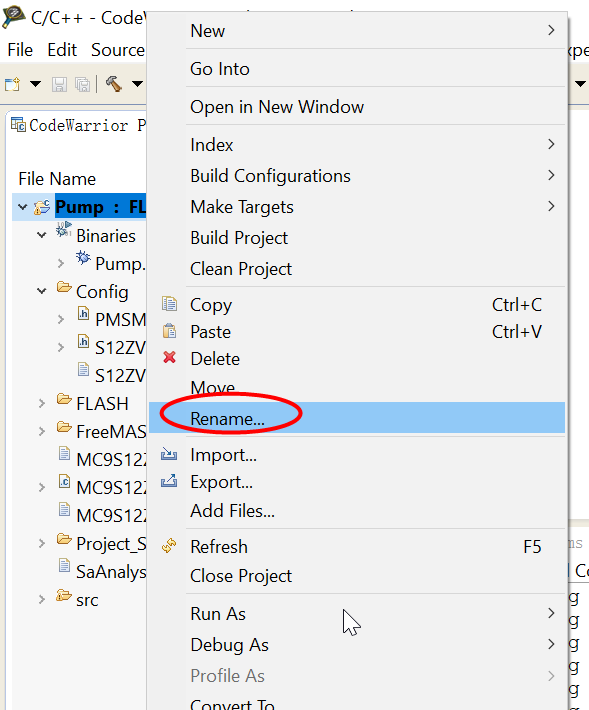

  I met some problems when I rename the project(Pump for example). I use CW11.0 and the demo AN5135SW. Any suggestion?

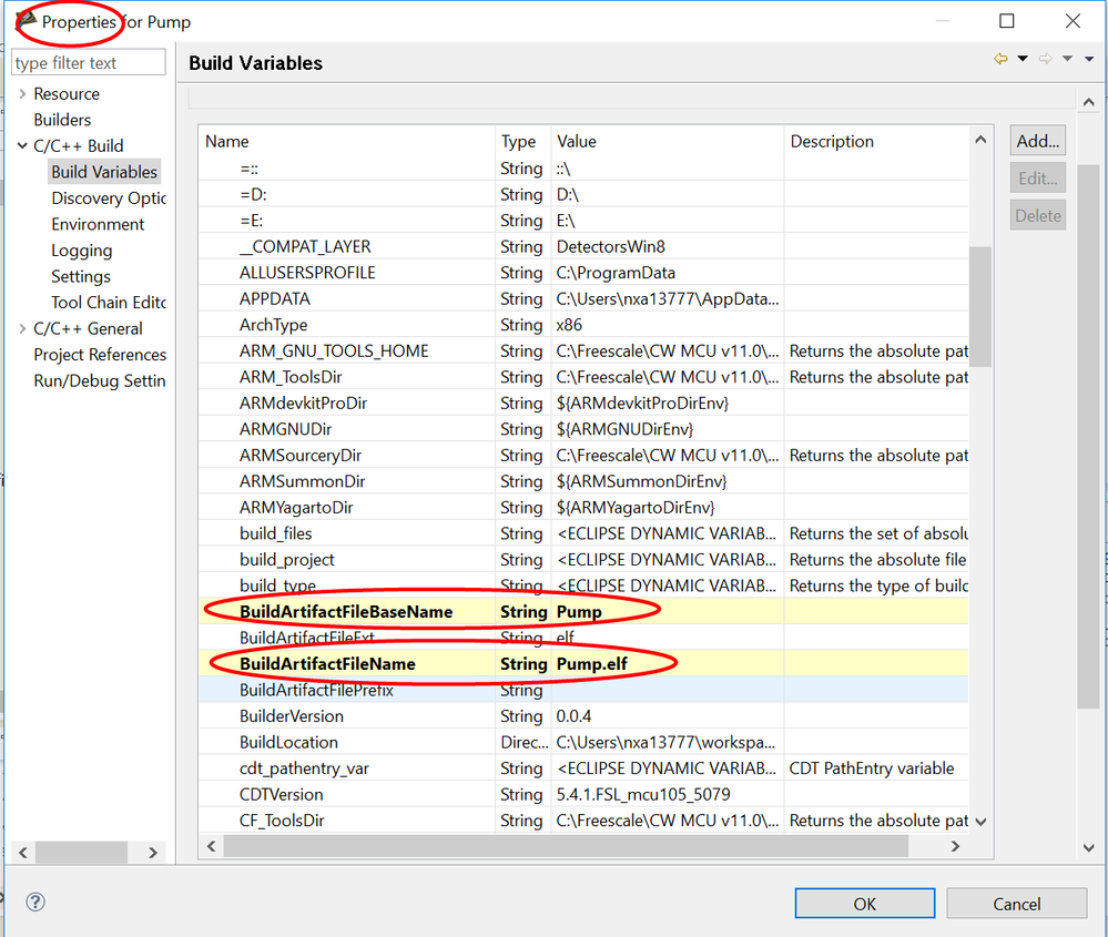

Please refer to my step have a try:
- Rename project :

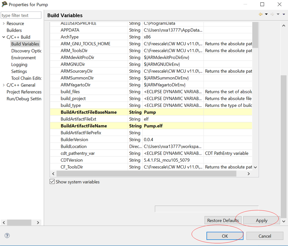

- Change  "Build Variables" in Properteis:
- Then press Apply and OK buttons:

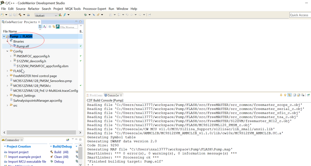

- Build
Hope it helps.

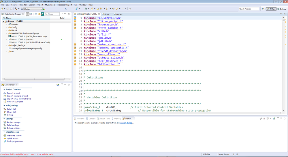

         I'm sorry ,it doesn't work. See my picture, it could not find include file'mc9s12zvml31.h' if I rename the project.QQ图片20180904135549.png

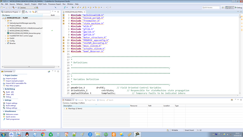

Hello Fran,
After change name, please try to close the proejct, then import it again .
Alice
2,503 Views
frankkong
Thanks Alice_Yang,
It works!
