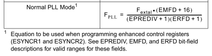

snehakalkhair
Hi Martin,
I request you to please help me understand the calculation of the frequency of system clock , eMIOS clock and duty cycle if i am using a 40MHz crystal for MPC5674F.
I am confused with the values set for ESYNCR1 and ESYNCR2 in the following code:
    // settings for 264 MHz
    SIU.ECCR.B.EBDF = 3; /* Divide sysclk by 3+1 for CLKOUT */
    FMPLL.ESYNCR2.R = 0x00000002;
    FMPLL.ESYNCR1.R = 0x70040032;
4,927 Views
martin_kovar
the first line (SIU.ECCR...) is not relevant. This only set CLKOUT frequency.
      while (FMPLL.SYNSR.B.LOCK != 1) {}; /* Wait for FMPLL to LOCK  */
FMPLL.ESYNCR2.R = 0x00000001;                  /* Fsys =264Mhz */
This is correct FMPLL settings for Fsys = 264MHz.
ESYNCR1 and ESYNCR2 are used to set Fsys frequency. Please look at the reference manual especially look at the following formula:
eMIOS clock is half of the sys clock. This means, if you set FMPLL to 264MHz, eMIOS clock will be 132MHz. eMIOS module contains it's own prescaler, which can be used for frequency adjustment.
I suppose you do not know, how I calculated the OPWM frequency and duty cycle in the example I sent you.
Let's say you have Fsys = 264MHz and you want eMIOS clock 1MHz:
Fsys = 264MHz
eMIOS clock = 132MHz ---you want 1MHz, you have to set prescaler to 132.
Now you have 1MHz in eMIOS input. It means that eMIOS counter increase it's value by 1 each 1us (microsecond). So I created time base using channel 23 and set CADR register to 999. It means one period lasts 1000 timer's tick (1ms). This is the OPWM frequency.
If duty cycle is 50%, it means that half period is signal in logical 1 and half period is logical 0.  This is determined by CADR and CBDR registers in appropriate eMIOS channel, which is set to generate OPWM.
Martin
