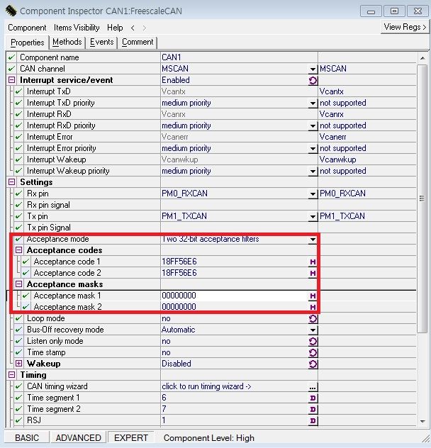

Hi. I am Kim from South Korea.
Now I have to use the CAN acceptance filter for extended id.(not standard id.)
(Last year I got an answer for standard filter from here and I complete it)
The id. That I should receive is 0x18ff56e7 and I set the code warrior as below.
Thank you.
Best regards.
Kim.

Hi Kim,
Could you tell us the MCU and CodeWarrior version being used?

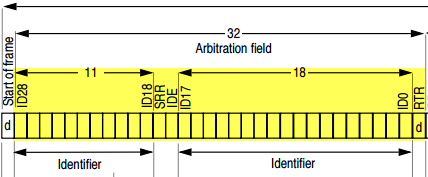

Regarding the acceptance filter, please remember that the acceptance filters are applied to the full 29 bits of the extended identifier and to the following bits of the CAN 2.0B frame: Remote transmission request (RTR), Identifier extension (IDE) and Substitute remote request (SRR).
So you should consider these bits in your acceptance code.
