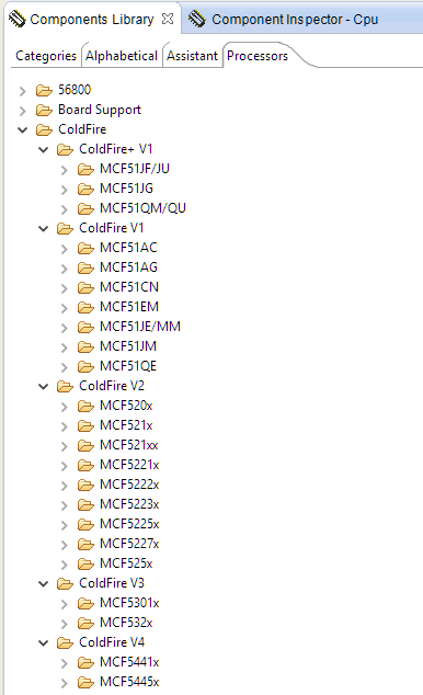

I am using Code Warrior 11 (Eclipse based) with Processor Expert for MCU installed.  I do not see an option to select PE when I create a new project for ColdFire MCU5484 processor.  Is PE not available for this ColdFire family or is there a separate step to select PE?  Any help will be greatly appreciated.

You can see which CPUs are supported in the components library:
The MCF548x is not listed/supported.
