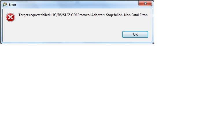

I am trying to debug my new project using CodeWarrior for MCU v10.6 and I am not able to debug it. I am trying to program HCS08 MCUs (MC9S08SG8 or SG32) with my USB Multilink Universal FX, but everytimeI need to program the microcontroller (on run or debug) I must power off and power on the power supply. When I try to debug, it seems to be hanged and when I click any option (pause, reset,...), I get the message: "Target request failed: HC/RS/S12Z GDI Protocol Adapter : Stop failed. Non Fatal Error."

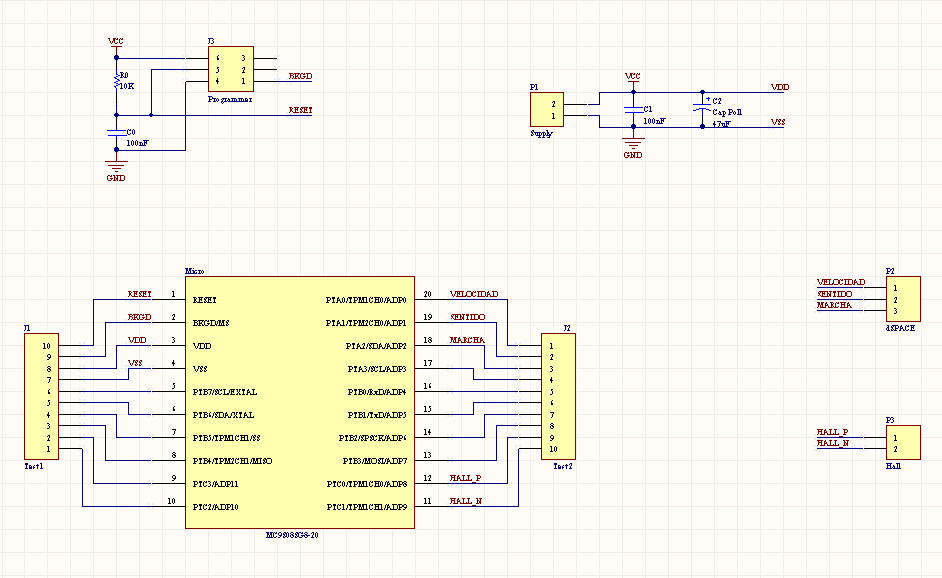

could you please check your schematic to see if RESET pin is properly connected.
the attached is a schematic for a demo board of MC9S08SG32 for your reference.
for your second problem, could you please upload an screen-shot for investigation?

I think RESET pin is connected ok. I have attached the schematic of the board where I am testing the code.
I have also attached the error message I get when I try to debug.
