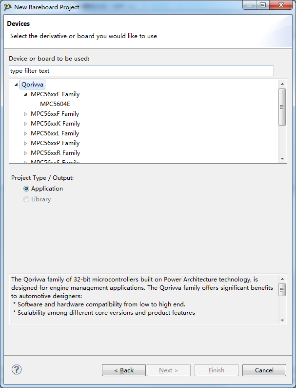

Dear,
I'm now working with MPC5606E for Ethernet commnuication. But I can't find the chip type in the Codewarrior 10.6 when I'm setting up a new project for MPC5606E.
So which Codewarrior should I install? Thank you!

Choose MPC5604E device. In an simplified way MPC5606E = MPC5604E + BCM89810 physical interface.

Hello Helen
The MPC5606E microcontroller integrates MPC5604E device with the Broadcom(R) BCM89810 single-port BroadR-Reach™ 100 Mbps automotive Ethernet transceiver. So you may choose MPC5604E when creating a new bareboard project for your application.
