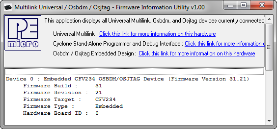

- Maybe it is an OSBDM firmware problem. Make sure you have the latest and greatest version. For reference, this is what I'm using 31.21OSBDM firmware.png
