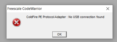

I am getting error "ColdFire Protocol Adapter : No USB connection found" while debugging. Debugger is detecting in Device manager and in other IDE like MCUXpresso.
Using Hardware/Tools:
IDE: Code Warrior 7.1.
Debugger: PE micro Multilink Universal FX.
Controller: MCF52211CA
OS: Windows 10
Some screen shot is attached for reference.
Error Message:
Device manager:
PE Micro
Kindly guide me.

You better install the pemicro drivers.
https://www.pemicro.com/support/downloads_find.cfm
