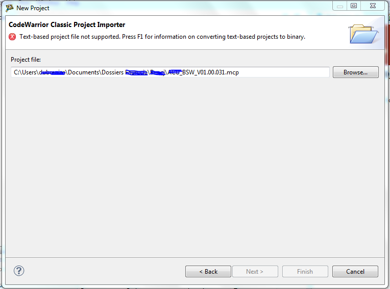

I'm trying to import a MCU executable file but I can not. CodeWarrior says no architecture is installed. How can I install these architectures please?

I'm working on CodeWarrior version 11, my chip number is MPC5634M.
Just some complementary information we can open, run and debug the project with codewarrior 2.10 but we can not open the same .mcp with codewarrior 11.
Here a screenshot:

Your project was made under codewarrior 2.10 which is classic CodeWarrior.
For MPC5, there is no way to import classic CodeWarrior project to eclipse., because CodeWarrior eclipse doesn't integrate classic Codewarrior for MPC5 importer.
User has to create a new project under CodeWarrior 11. then manually import our source code part by part.
