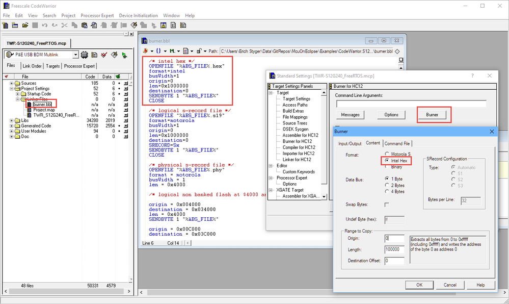

Hi.
I am currently using Code Warrior IDE 5.9.0 version.
Currently I want to create a HEX file using this program, but I want to know how to make it.
Thank you.
2,129 Views
ErichStyger
Specialist I
you can use the burner utility for this. You find related articles how to use it in:
S-Record, Intel Hex and Binary Files | MCU on Eclipse
S-Record Manipulation with GNU objcopy and Burner Utility | MCU on Eclipse
I hope this helps,
Erich
