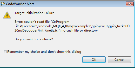

I am using CW10.2 and K60f120.
But when I try to debug the project, but it has error"MQX kernel data not found".
Is there some configuration I need to do to make it work?
Thank you.
-Daniel

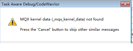

danieldelatorre
What debug file did you edit to fix this problem?  I'm having the exact same problem and it is driving me nuts!  Thanks in advance if you reply to this post.
3,679 Views
danieldelatorre
I'm pretty sure that there are multiple ways of seeing the "MQX Kernel Data Not Found" error dialog window, and your case might be a little different from my case.  In my case it went away after I selected the 'Generate debug information' as seen below.  After properly setting this I was able to use debug and use MQX TAD feature in IAR Embedded Workbench.  My main issue was that I needed to use Task Aware Debugging (TAD) in IAR Embedded Workbench but I kept seeing an error message when I tried to debug and use TAD.  To get passed this I had to make sure that all of my static MQX libraries and my own application output enabled 'Generate Debug Information.'
I hope this helps someone else, took me a while to figure this one out. .

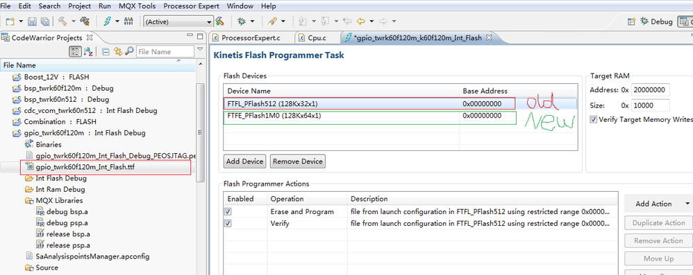

danielchai
Senior Contributor I
Did you try to edit the flash device?
If you device's flash is 1M, but the flash file is based on 512K, then it will have problem.
You can try to change it corresponding to your MCU.
-Daniel
