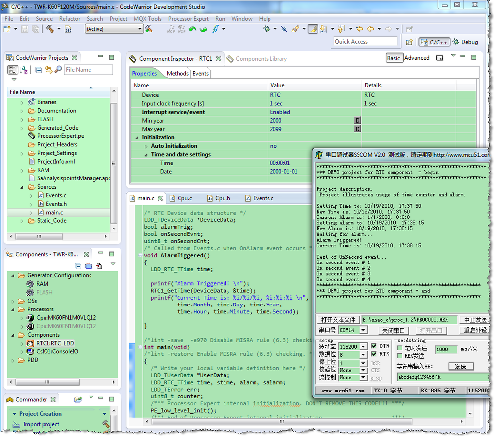

Hi Markus,
Sorry for the late reply!
Please refer the attached RTC_LDD example. I have test it on TWR-K60F120M board with CodeWarrior10.7.
Robin
