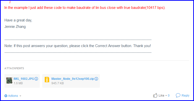

ZhangJennie
Hi salman,
The attachments are visible from my side. Can't you see it on your side? see what I see below:
Anyway, I just sent these files to your email (@gmail.com). Please check it also.
Jennie Zhang
