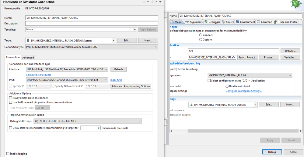

johannesoksanen
Yes,I am using correct one. As I mentioned above J-link device appears in Windows Device Manager and there is a driver version 2.70.8.0 installed. However there is some problems. This is what I get from
"Error launching SPI_MK40DX256Z_INTERNAL_FLASH_OSJTAG
ARM GDI Protocol Adapter : Can't connect. The Debugger can not connect to the P&E device"

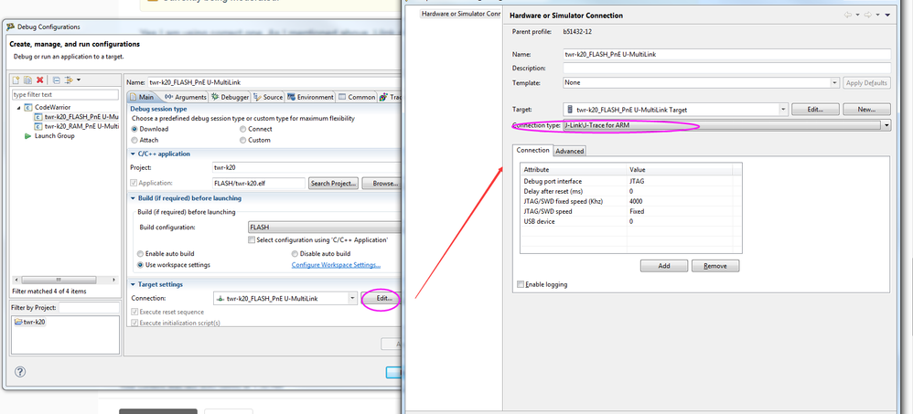

Hello Johannes,
Please choose J-link in the debug configuration view :
If still have problem , could you please take a video or screenshots to show your configuration and steps.

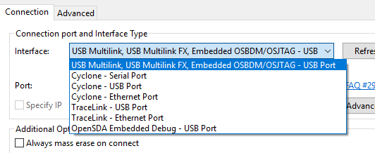

johannesoksanen
I went trough all options on the list, none of them are correct :smileysad: There is no "J-Link" option available. Is that my main problem?
