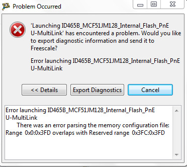

I have migrated my CW V10.6 tools to a new laptop. When I imported a design (Coldfire MCF51JM128 product design) from my old laptop ( which also was running V10.6) I successfully compiled the design but am failing to programme the devices on my custom board. The board was working with the old laptop, but now I get an error;
I'm not sure where the configuration file is stored/generated, can anyone help me please.

The memory configuration file is usually stored inside <project>\Project_Settings\Debugger\*.mem

hi Ken,
from the error screenshot, the error is on the memory configuration file. please refer with attached video to check your memory configuration file setting.
I also attach MCF51JM128.mem from my side.
can this help?
