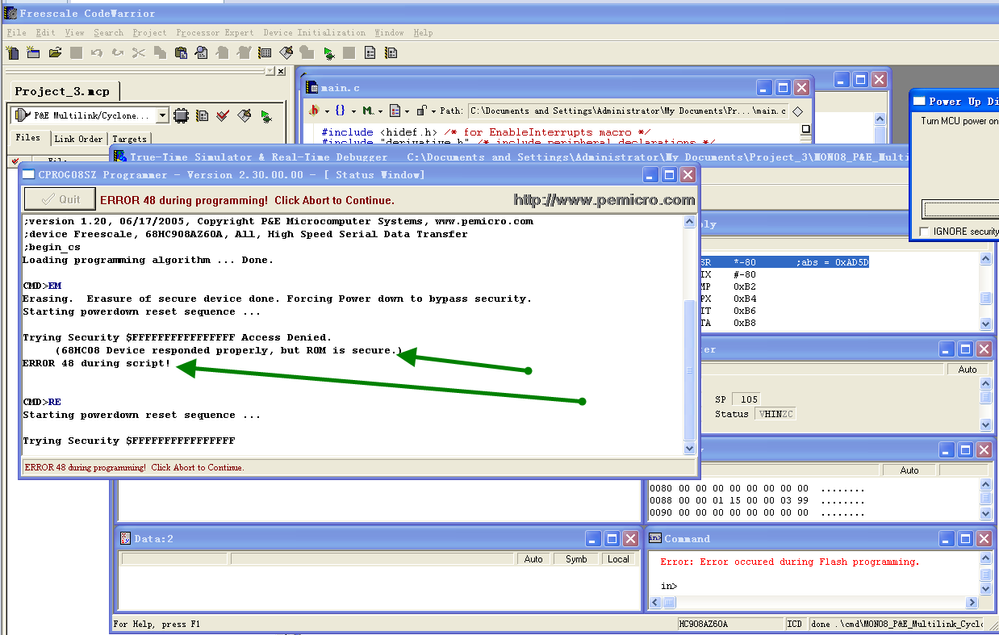

How to solve the ROM is secure for MC68HC908.

How to solve the ROM is secure for MC68HC908.Thank you for your help!

Hello Bill
CW debugger perform unsecure by mass erase the flash during download process by debugger.
In order to solve your problem, we need to know:
1. your windows platform?
2. what emulator tool you work with? The emulator interface?
3. How it works if you create a new project with wizard?
4. Can you test the board on another computer ? How does it work?
